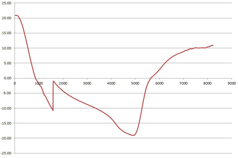

describing a simulation that took place in a climate chamber. I have attached a
graph describing the temperature on the water container surface. I want help modeling
that step-up near the 1600s mark, how should I "make the water warmer" before it starts
cooling again? I have looked into the continuous casting model for guidance and I have
used some methods described in it but I am stuck...

I would suspect some difficulties to make it a true "step" but if you use a combination with the v4 "step" function and use smooth corners, I believe you could manage, but you would need to find a way to tweak your solver to detect the step and take "small" solver steps to resolve the steep gradients
gets smoothed or averaged over instead of having that relatively steep step.
I don't mind so much at the moment because the final result is "close enough"
but, you know how it is, wanting to get it precisely right ;)I tweaked the solver to
take 0.5 sec steps around the step area but it did not do any difference.

The "problem" is that in during the climate chamber simulations the water is standing still and thus allowed
to be supercooled before turning into ice. I might have to repeat the simulations trying to force the phase transition
(by jiggling the container maybe?) around the 0°C point in order to get a smoother behavior.

Sorry, but I still don't make an idea of your model and why you are unconfortable with the graphics T vs. t. If you could provide a simple (better 1D or 2D) version of the model, perhaps we would be able to help you more.
Nevertheless, I have inspected your Cp function, and it has a sudden and strong peak at T about 273[K] (Cp reaches 1.92075e5 at T = 0[degC]!!!). Is that what you intend? How do you distinguish water from ice? Why don't you take into account the difference in k (thermal conductivity) and rho (density) between both phases? Could you go without any geometry, and thus use only an ODE?
Jesus.
