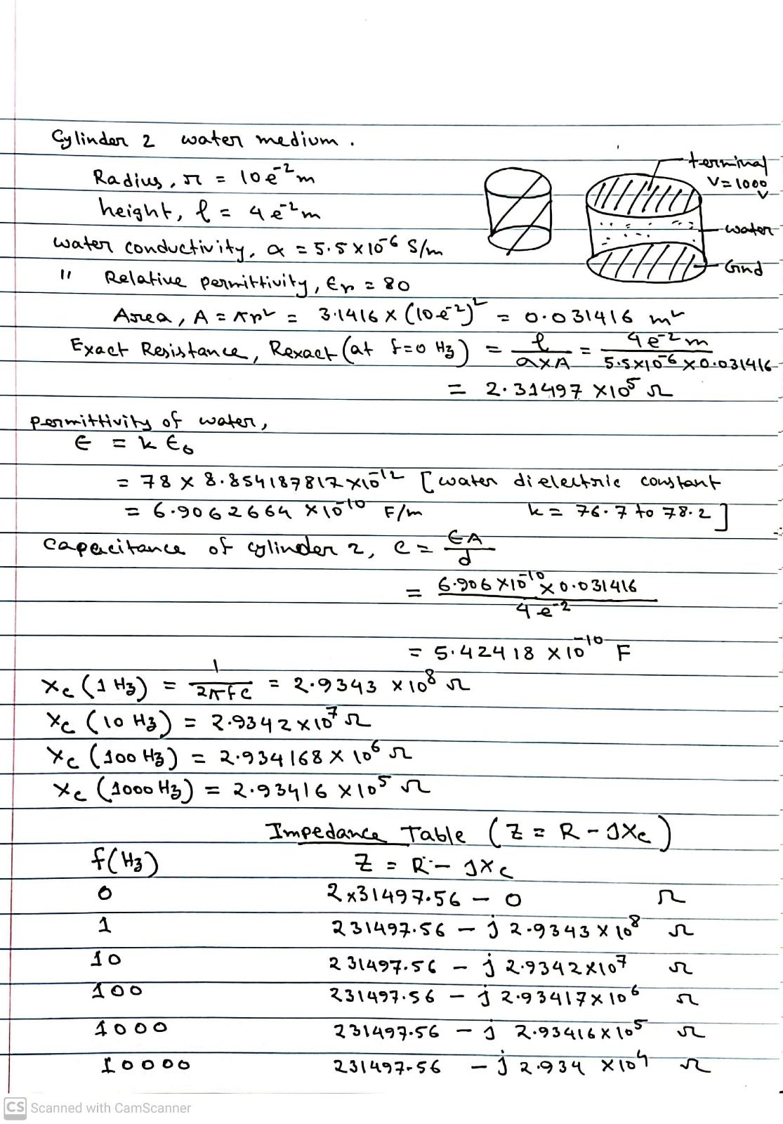

Hi, I am trying to measure the impedance of water medium. I have calculated impedance (given in the jpg) and made a table with varying frequency. The problems that I have encountered with my model (given in mph file) are,

  3. Reactance part should be decreased with frequency. And also the value should be similar to my calculation. Am I using the wrong equation for impedance? (1/ec.Y22)
