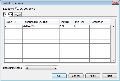

Posted: 1 decade ago 16 nov 2012, 19:40 CET
See the image attached.
Good weekend.
Jesus
See the image attached. Good weekend. Jesus

Posted: 1 decade ago 17 nov 2012, 07:39 CET
Sir how can i learn usinf comsol efficiently. for me teacher is better is than book. do u give online classes?
Posted: 1 decade ago 17 nov 2012, 08:09 CET
her is the error i m haveing
Error: 6164
Duplicate variable name.
varaible:N
varaible:Nt
varaible:Ntt
varaible:N
varaible:Nt
varaible:Ntt
how to handle it.
note : in draw section: for my equation dN/dt=N(1-N), i drew a line from 0 - 1
this represents length of independent varable t . then on page Solver parameter
field: Times= 0:0.001:1
field: Relative tolerance: 0.01, by default (should it remain the same)
field: Absolute tolerance: 0.0010 , by default (should it remain the same)
after this press OK?
please notify if i m wrong at some step.
regards
her is the error i m haveing Error: 6164 Duplicate variable name. varaible:N varaible:Nt varaible:Ntt varaible:N varaible:Nt varaible:Ntt how to handle it. note : in draw section: for my equation dN/dt=N(1-N), i drew a line from 0 - 1 this represents length of independent varable t . then on page Solver parameter field: Times= 0:0.001:1 field: Relative tolerance: 0.01, by default (should it remain the same) field: Absolute tolerance: 0.0010 , by default (should it remain the same) after this press OK? please notify if i m wrong at some step. regards
