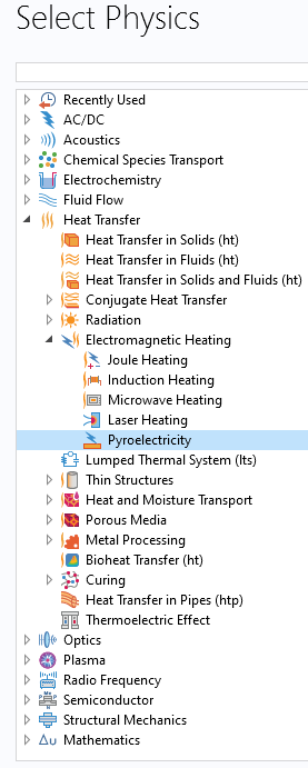

Hi all, I am trying to model electrocaloric effect in COMSOL. Electrocaloric effect is nothing but the adiabatic temperature change due to the appled electric field. For achieving this what Multiphysics module should I use? Any help in the matter is highly welcomed.

Seems like you are looking for the Pyroelectricity multiphysics interface. It is new in version 6.1. See the attached screenshot.

Thank you for your reply. But I am looking for the inverse phenomenon of pyroelectric effect. Is there any module for generating the inverse pyroelectric effect?
