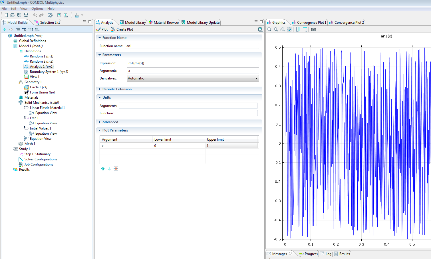

I have 2 random functions in my model- rn1 and rn2. I need rn2 to be dependent on rn1, but when I try to call rn1 into the rn2 function, comsol does not recognize it as a variable.
Does any one know if it is possible to make 1 function dependent on another function within 1 model?

it works for me, or have I missed something ?
Hi it works for me, or have I missed something ? -- Good luck Ivar

I never tried using the analytic function!
Thanks for the tip!
I never tried using the analytic function! Thanks for the tip!
