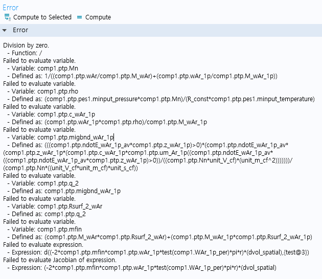

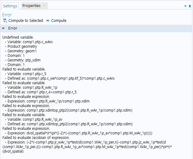

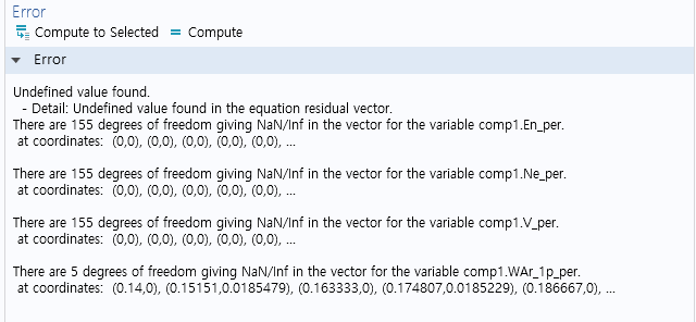

Hello, I am designing a Capacitively Coupled Plasma reactor in a 2D Axisymmetric Plasma, Time Periodic model. Unfortunately, I am facing an error whenever I try to compute the study. I am also a little bit confused about the connection of the electrodes. I am attaching my work as well as a photo of error along with this query. It would be really great if someone suggested what to do to me. Thank You!

Dear Sir, First of all, thanks a lot for your suggestion. According to your instructions, I have made changes to the parameters and cross section data of plasma. I have also been reconfiguring the mesh frequently. Unfortunately, I am facing these errors with my work.
