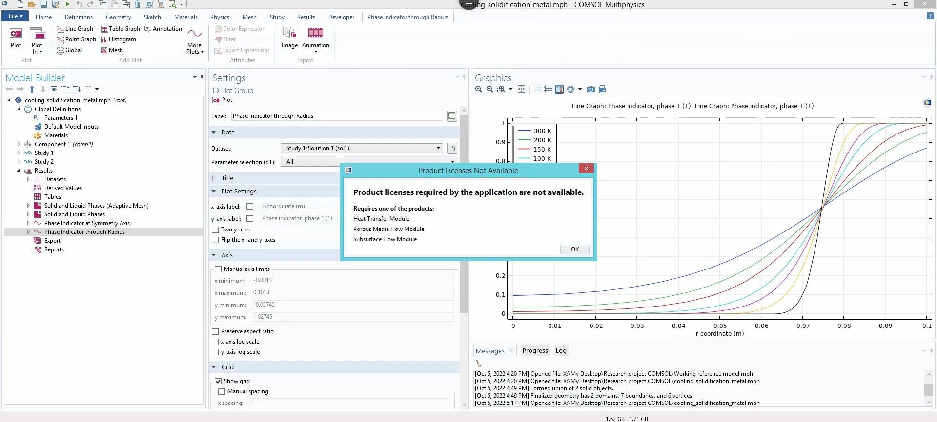

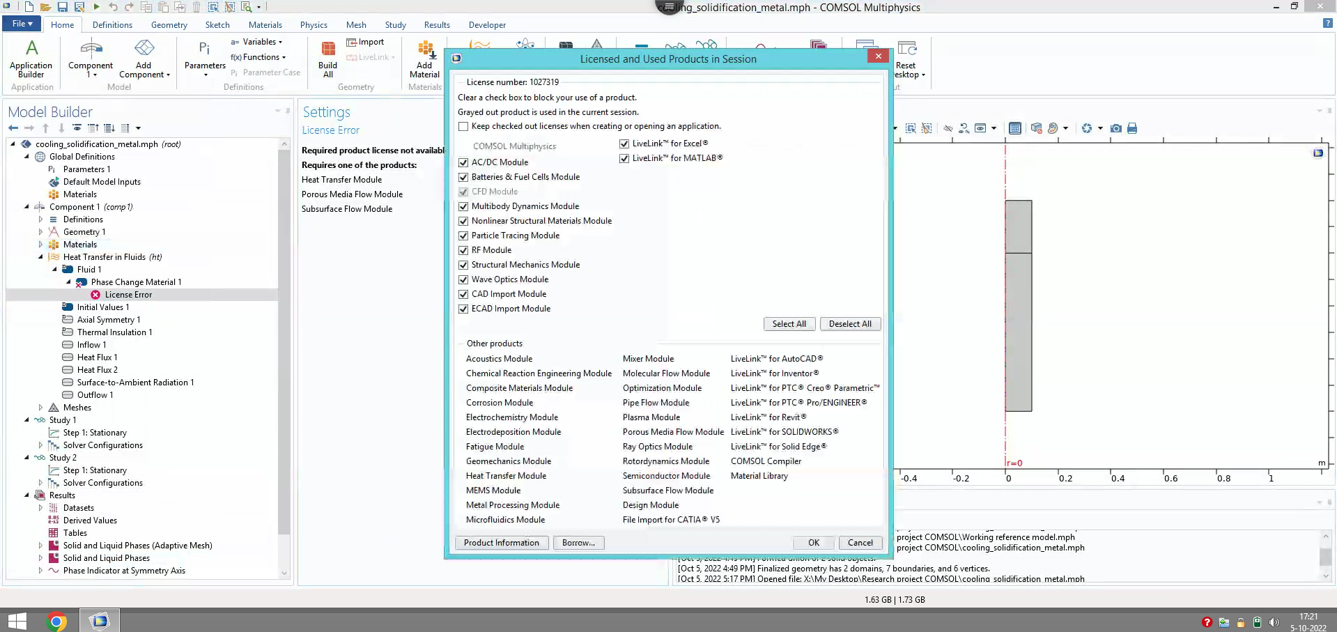

For some reason I am not able to load the metal cooling tutorial in comsol 5.5 due to a missing phase change material license. However, I think I should have access to these modules with my university licence number as heat transfer in fluids has worked for me before. It only causes issues when using phase change material under Fluid 1, as displayed in the attachments.

Hello Maurits,
You can model some heat transfer in fluids without having any of the three modules listed on the screenshot "Licenses not available.png", so there is no contradiction here.
Jeff Hiller
Hello Maurits, You can model some heat transfer in fluids without having any of the three modules listed on the screenshot "Licenses not available.png", so there is no contradiction here. Best regards, Jeff
