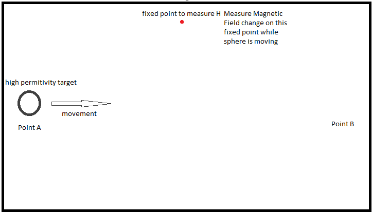

I have an sphere with high relative permitiivity on a specific position on a rectangle domain. There is a background reduced magnetic field and I am measuring how the magnetic field is affected by the sphere. I measured it using different sphere locations on the domain but all stationaries scenarios.
I would like to make the sphere move from point A to B and see in an 'Animation' how the field is changing. I tried parametric sweep but it does not work for geometry parameters. Any suggestions?

parametric sweeps do work for geometry parameters. Only auxiliary sweeps don't.

Thanks Edgar. I did worked
