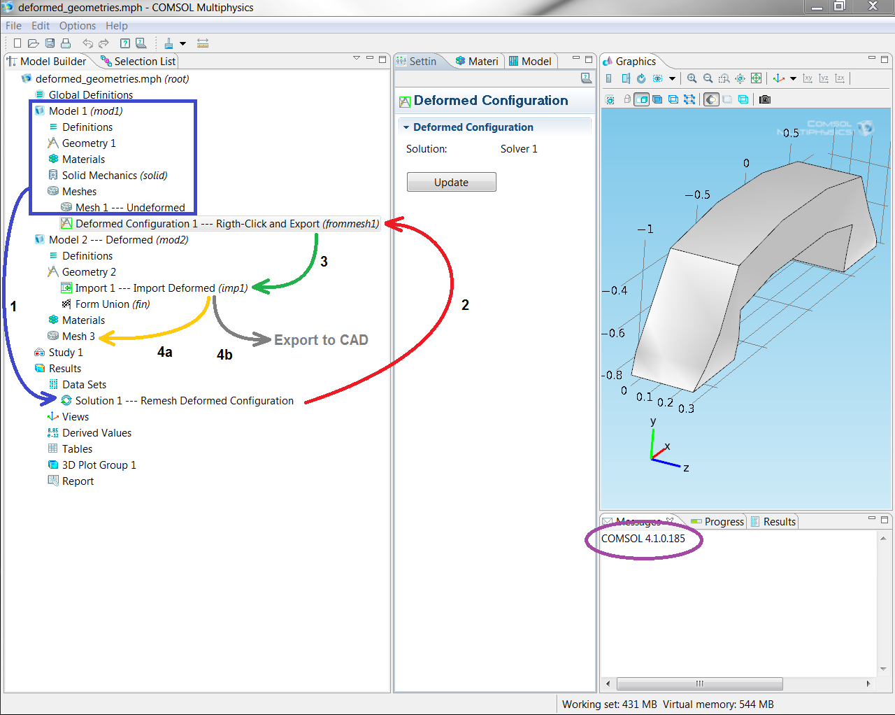

On the topic above, I have essentially the same question, i.e., I would like to take the deformed shape from an initial study and then remesh the resulting deformed geometry in order to run a second study. (For my particular purposes in this study, I am not concerned with the stress and strain states that develop from the first study; I'm just interested in the deformed shape as the starting point for a new study.)
I ran across the attached instructions from one of the other consultants (Goran ??), and it appears to lay out a guide for doing exactly what I want to do. BUT it does not work as laid out here in my version of 4.3a. And one of the other writers into the forum mentions that he found that it also did not work 4.2a although it did in 4.1 Any suggestions on how to accomplish this goal in 4.3a?
