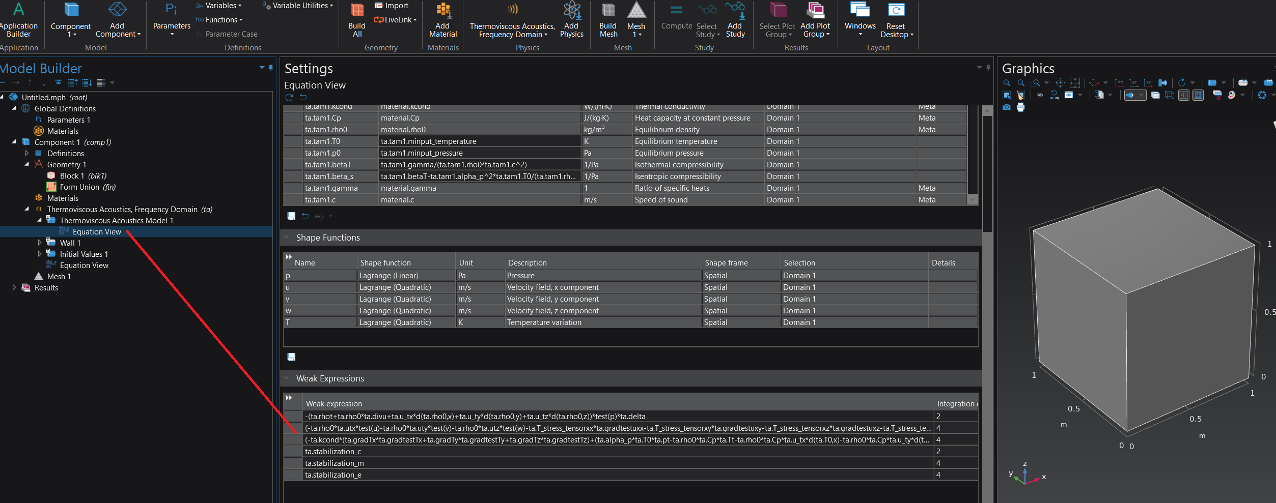

Briefly, i'm designing a hydrogen storage tank, which has porous metal hydride bed inside. For the momentum conservation at the porous area, I need to use the given equation below. It seems that physics interface of "Brinkman Equation" gives a similar form of Navier-stokes equation. However, I need to remove a certain term as I marked in the image below so that the equation to be exactly same shown above.
I am aware of the "Equation View" option, but still got stuck... or shall I use the equation-based modelling such as Mathematics physics interface?

Make sure you have a geometry associated with the physics first. Then go to the physics node and modify the weak form of it. You will get a padlock symbol on that node to indicate that something has changed.

Hello René,
Thank you for the reply. I found the equation at the weak expression table. In order to change 'only' the pre-defined equation, am I supposed to modify the expression in the weak expression only? Not the variables?
