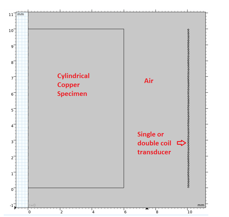

I have a problem. I want to investigate the influence of the eccentricity of a cylindrical copper specimen inside a single or double inductive transducer on the output parameters of this transducer, i.e. impedance in the case of a single coil inductive transducer or voltage in the case of a double coil inductive transducer. To model such a problem I used the 2D Axisymmetric Model of AC/DC Module. However, I cannot find a way to model the eccentricity of a specimen in a 2D axisymmetric model. Can you give directions on how to obtain eccentricity in a 2D Axisymmetric Model?

Teodor,
eccentricity violates axial symmetry.
Cheers Edgar
