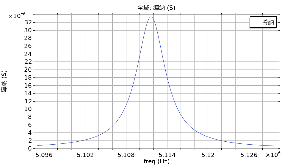

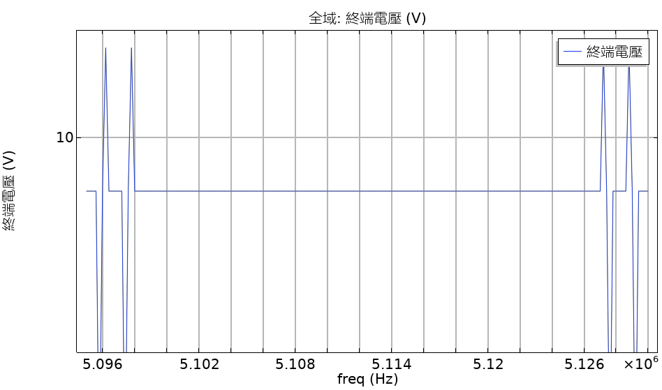

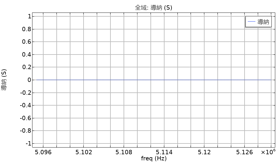

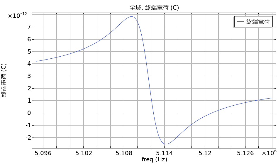

I'm now trying to find the admittance curve of a piezoelectric disk immerse in the water, I used AWE to sweep the wide range of frequency. However, when I want to use the global value es.Y11 to calculate admittance (I used terminal as voltage source of piezoelectric disk), the value are all zero, and I also plot the terminal charge es.Q0_1 and terminal voltage es.V0_1, the es.Q0_1 is always zero. But I used normal frequency domain study to do the same thing, surprisely the admittance curve was shown up. I doubt that AWE has some bugs, or did I miss something?

Finally found the reason why AWE can't calculate admittance value.
The reason is that when you use AWE study, the operator reacf() which is used in calculating admittance is automatically replaced by zero, so no matter how you fix the model, you will never get the admittance value!
The solution is to remember to go to the terminal node settings, constraint settings, there is a button called [Use Weak Constraints], which must be clicked.
