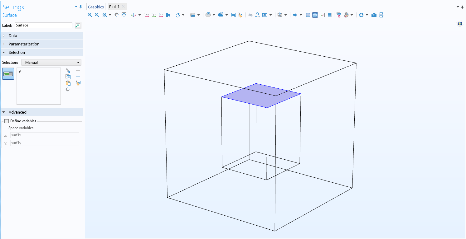

I'm trying to create a plane to create a surface average of current density.
A surface layer can only do the top and bottom layer, and a cut plane also includes the air domain beyond the sample, which I don't want.
How can I create a plane that only includes the sample, but can be placed at any depth within the sample? Please see images for explanation.
I hope this is clear, thank you!

Hi Felix,
There's an old thread for that.
Jeff Hiller
Hi Felix, There's an [old thread](https://www.comsol.com/forum/thread/265671/selecting-domains-for-plot-using-the-filter?last=2020-07-21T06:29:20Z) for that. Best, Jeff
