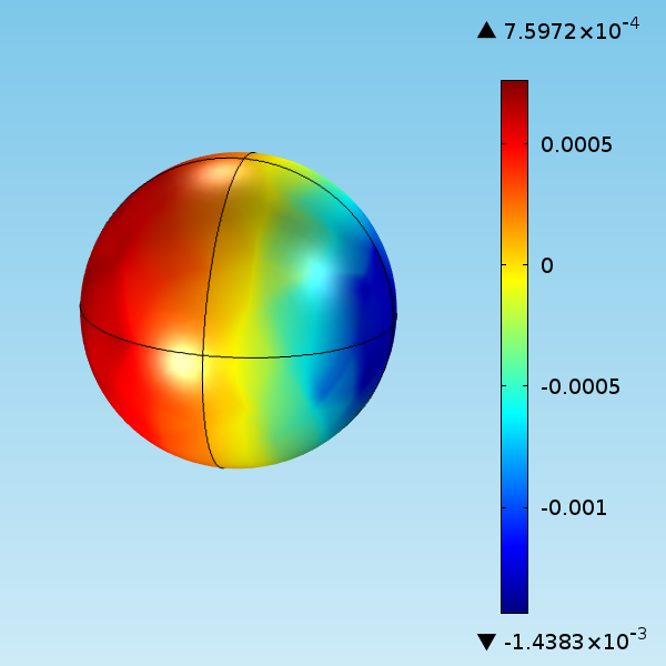

                                                    I ran your model, as is, and got the result you can see in the attached figure. I guess this what you (and I both) were expecting.
However, I'm using the latest Comsol version, 4.3, whereas you seem to be on 4.2a. Luckily, I still have the old version installed, and when I ran the model there, I could reproduce the error you described ("Failed to evaluate variable. [...] mod1.es.nD"). I would think this is (or was) a bug.
As to if and why there's a bug, you can only get a definitive answer from Comsol's developers, via Support. But if I was to venture a guess, it would be that, in the old version, the surface charge density was not defined properly on (some or all) interior boundaries.
I suspect that because, when you switch on "Equation View" (from the "Show" drop-drown menu in the Model Builder tab), you can see that the surface charge density is defined whenever you add a boundary condition such as "Ground" or "Electric Potential", but not for the "Floating Potential". This is different in 4.3.
The Equation View is also your way in to working around the bug in 4.2a. Just define a new variable (say, nD) on all boundaries, and copy the expression from the Equation View: es.unx*(down(es.Dx)-up(es.Dx))+es.uny*(down(es.Dy)-up(es.Dy))+es.unz*(down(es.Dz)-up(es.Dz)). By the way, this is just the defintion of the surface charge density, n·(D₁-D₂), at an interface between media 1 and 2 with normal vector n, expressed in terms of Comsol's internal variables. You can also plot the above expression directly.

                                                    Thank you so much for your help!  This makes me feel a little better about myself since I couldn't figure out where I was going wrong.
I was having a problem defining my own variable (and with the variables unx, uny, unz), but plotting the expression manually gives me exactly the result I needed.
Thanks for helping me solve this problem!  I hadn't done much with the equation view before, but now I see it's value.
