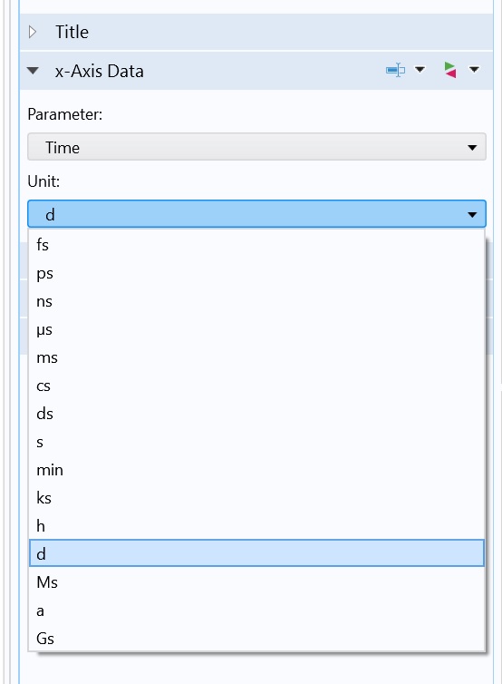

Well, apparently you can use days as the units of time. That's pretty similar to using dates, right? In plotting the values from a time domain simulation in post processing, you can expand x-Axis Data and choose your units. See the attached partial screen shot. If that's not good enough and you can't find another way, then perhaps it would be easier for you to export the plotted data to Excel, or something like that?

One option may be to generate annotations by a respective JAVA method.
