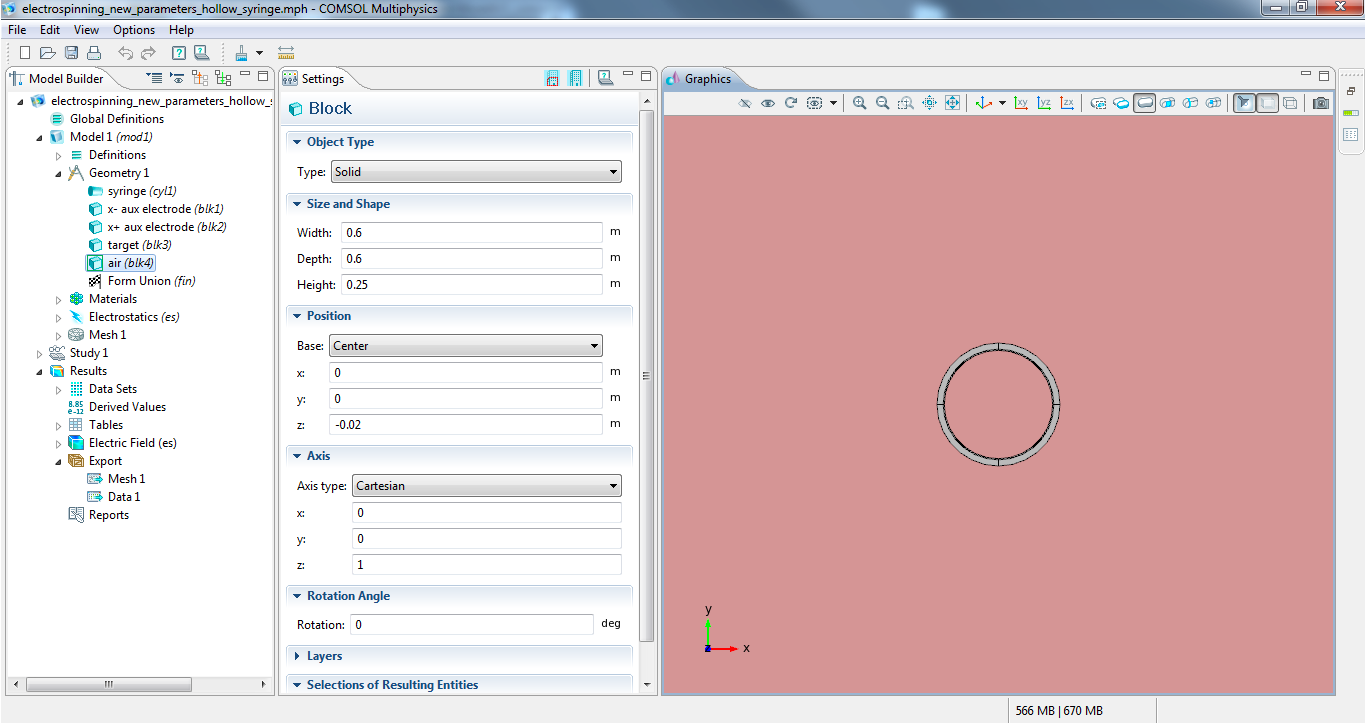

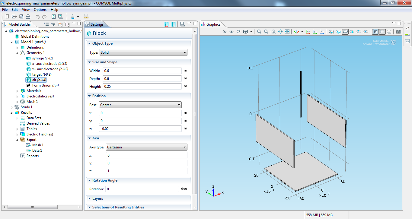

Edit: Maybe some screenshots can clarify the whole problem. Screen1 is just an overview, screen2 a top view to show the cylinder in detail. A big block of air surrounding the whole thing is hidden both times to makes everything else visible.
