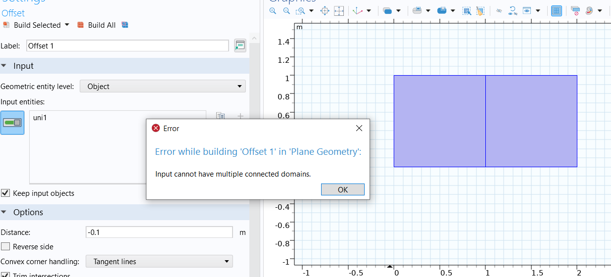

We cannot open hour file without the design module but we had a try offsetting the shapes in the meantime.
Offsetting cannot have multiple connected domains (see 1st picture) When selecting all shapes in work plane, then we have disconnected shrunk shapes (see 2nd picture).
Then if we'd extrude and loft, we would get an "internal" slope between the 2 squares, wouldn't we?

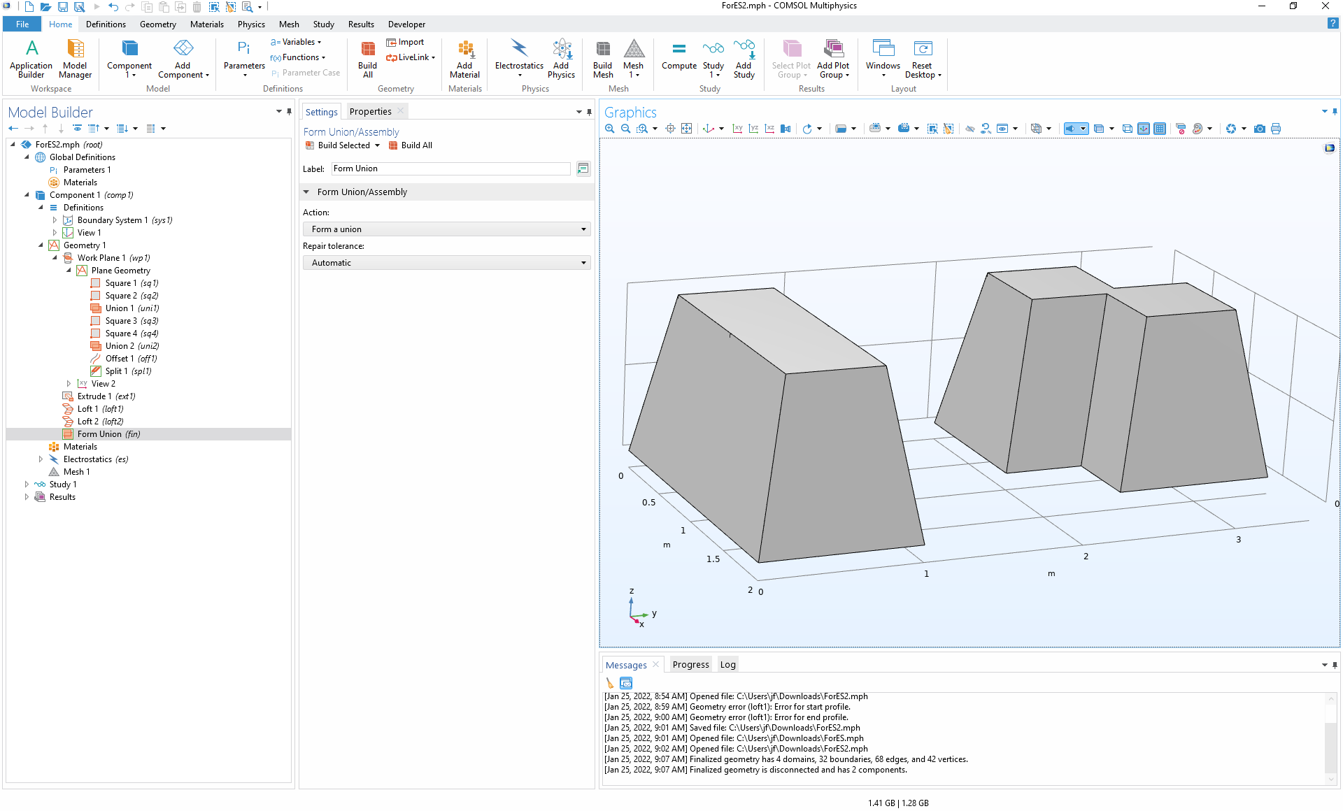

Hello Eric,
In that case (overlapping or contiguous squares/rectangles), you can take the union of the two squares/rectangles with the "keep interior boundaries" checkbox turned off (this will remove undesired internal edges) before taking the offset.
See attached screenshots and mph file (for when you can open it). One of the screenshots shows a Split operation that I did not mention yesterday.
Jeff Hiller

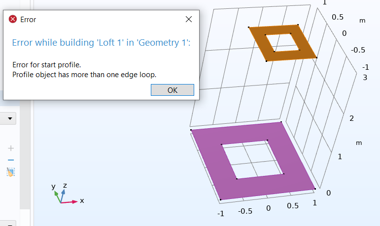

I guess the inital exemples I gave were a bit too simple. Eventually, our final geometry to be extruded is composed of rectangles than can form shapes such as a rectangle hollowed out by another rectangle.
The steps you suggested are working great if you have a single edge loop but breaks down when we have more than 1, at the level of the loft feature.
I guess we could make many single edge loop shapes, perform the operation and then try to merge vertices at interfaces but we are steering away from a simple and elegant solution.
Any suggestions, anyone working with structures having non vertical sidewalls?
Pictures in copy: 00 and 01 are showing a case where the steps work because we have only one edge loop. 02 is showing the more complex actual use case we'd like to handle and the associated error.
BR, Eric

Hi Eric,
Lofting does work one loop at a time, so for the case you describe in your latest message you can use two loft operations, one for the inner loop and one for the outer loop, as shown in the attached files.
Jeff Hiller
