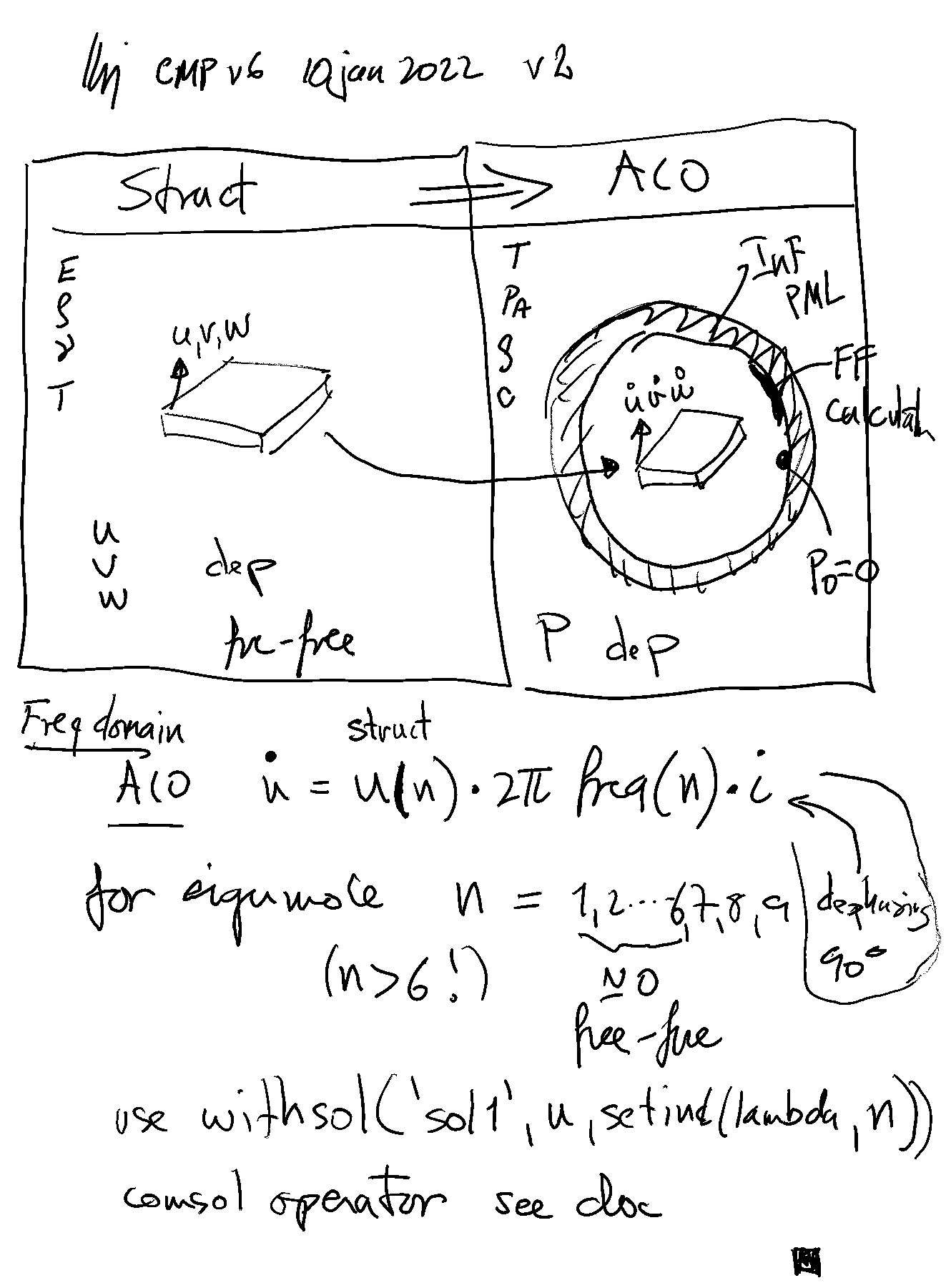

What I often do is to sketch up the links, as in the page below from my Remarkable(r) notebook :)

PS with updated _v2.PNG containing the "i" ...

Hello again,
I noticed I have a slight error in my notes, the displacement, velocity respectively acceleration are dephased by 90°, each, so the correct formula for a boundary displacement is d(x,y,z)[m], the velocity is v(x,y,z)=d(x,y,z) * (2 * pi * i * freq) and the acceleration is respectively a(x,y,z)=d(x,y,z) * (2 * pi * i * freq)^2. As COMSOL is working in true complex notation. You will notice that if you use the ACO boundary "normal displacement", or velocity, respectively acceleration you will find these equations in the "equation view" showing the internal COMSOL equations. the complex "* i" includes then the dephasing, but normally for your case the amplitude shape should not change.
Sincerely Ivar

Hello again, I noticed I have a slight error in my notes, the displacement, velocity respectively acceleration are dephased by 90°, each, so the correct formula for a boundary displacement is d(x,y,z)[m], the velocity is v(x,y,z)=d(x,y,z) * (2 * pi * i * freq) and the acceleration is respectively a(x,y,z)=d(x,y,z) * (2 * pi * i * freq)^2. As COMSOL is working in true complex notation. You will notice that if you use the ACO boundary "normal displacement", or velocity, respectively acceleration you will find these equations in the "equation view" showing the internal COMSOL equations. the complex "* i" includes then the dephasing, but normally for your case the amplitude shape should not change. I have updated the PNG above to ..._v2.PNG Sincerely Ivar
