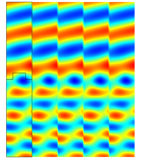

I think the intensity of the electric field behind the grating can differ from one unit cell to another as well.
Let's assume the electric field propagates towards the grating with the angle alpha = 15°. I will attach a picture of the duplicated solution for ewfd.Ez for this case. The problem with this solution is that in each unit cell the electric field does not reach the grating in a different phase and the respective electric fields of the unit cells do not interfere with each other. Thus, there is not the proper near or far field.
I am looking for a solution with a continuous wave that is propagating with the angle alpha towards the grating. There is the option to duplicate the geometry in the first place before computing but in my case I would have to compute the solution for 5000 unit cells which would be too much work for my PC.
Can you think of a way to get the correct near field for a width of about 2 mm without building a geometry this big? Is it possible to use the periodic boundary condition for this?
I think the intensity of the electric field behind the grating can differ from one unit cell to another as well. Let's assume the electric field propagates towards the grating with the angle alpha = 15°. I will attach a picture of the duplicated solution for ewfd.Ez for this case. The problem with this solution is that in each unit cell the electric field does not reach the grating in a different phase and the respective electric fields of the unit cells do not interfere with each other. Thus, there is not the proper near or far field. I am looking for a solution with a continuous wave that is propagating with the angle alpha towards the grating. There is the option to duplicate the geometry in the first place before computing but in my case I would have to compute the solution for 5000 unit cells which would be too much work for my PC. Can you think of a way to get the correct near field for a width of about 2 mm without building a geometry this big? Is it possible to use the periodic boundary condition for this?
