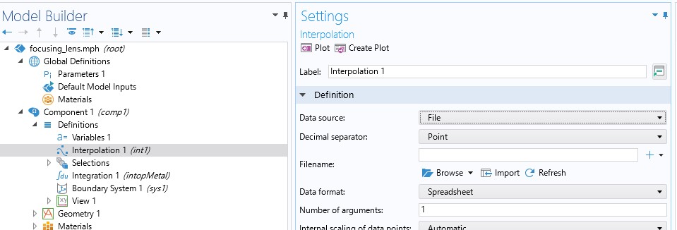

Hi Jesco
If you use "COMSOL's interpolation function" without using Matlab, you can use the exported data source as an input field as it is.
If you want to use complex amplitude, you can separate the real part and the imaginary part to generate two real-valued functions, and specify the complex amplitude using the two functions at the input port.
I'm not a Comsol advisor, so there may be an easy way to set up a complex interpolation function apart from this one.
