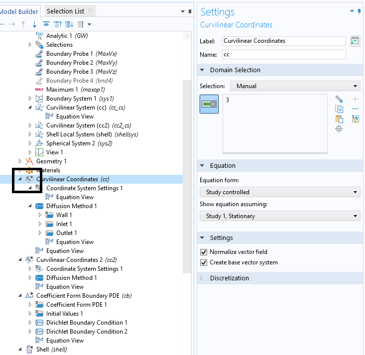

What if it is on the other nodes? It is on a curvilinear coordinate node and I did not see any button I can press or any empty section in the section I can fill to remove the "editing" status.

Hi Junfeng,
In the case of physics interfaces (such as in the attached screenshot), the asterisk has another meaning: It indicates physics interface nodes that have been disabled in a study step. So, those asterisks are only removed if the corresponding physics interface is enabled in all study steps. This is also mentioned in the documentation (see the "Dynamic Nodes in the Model Builder" section in the COMSOL Multiphysics Reference Manual).
Magnus
Hi Junfeng, In the case of physics interfaces (such as in the attached screenshot), the asterisk has another meaning: It indicates physics interface nodes that have been disabled in a study step. So, those asterisks are only removed if the corresponding physics interface is enabled in all study steps. This is also mentioned in the documentation (see the "Dynamic Nodes in the Model Builder" section in the *COMSOL Multiphysics Reference Manual*). Best regards, Magnus

Thank you very much! There are two studies in the model. The physics interfaces with asterisks are only used for one study. I tried to included them for both, the asterisks did disappear.

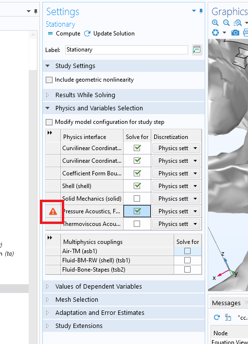

BTW When I included some physic interfaces into one study, a warning sign showed up in the table. How can I get the information about the warning?

Hi Junfeng,
This warning appears if you have selected the Solve for check box for a physics interface that is not compatible with the study type. The warning disappears if you clear the Solver for check box. Regardless of that setting, the study does not solve for that physics interface. In our latest version, 6.0, the Solve for check box is cleared and disabled in such cases, so there is no warning (and you cannot solve for it). In version 6.0, you also get information about the equation form for the physics interfaces in this table.
Magnus
Hi Junfeng, This warning appears if you have selected the **Solve for** check box for a physics interface that is not compatible with the study type. The warning disappears if you clear the **Solver for** check box. Regardless of that setting, the study does not solve for that physics interface. In our latest version, 6.0, the **Solve for** check box is cleared and disabled in such cases, so there is no warning (and you cannot solve for it). In version 6.0, you also get information about the equation form for the physics interfaces in this table. Best regards, Magnus
