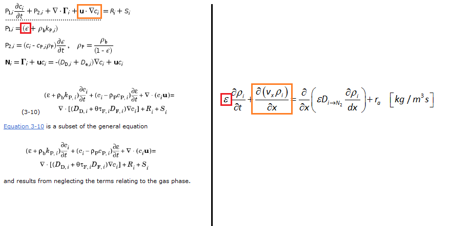

Anyone have an idea? Thanks.

Dear Juergen,
thanks for your help :) . I am however not entirely sure this is about the same thing. From what I can tell, the text you found explains how to calculate the Darcy velocity into the interstitial velocity. But I don't really see how this connects to the question if the porosity should be in the convective part of the differential equation.
I do appreciate the help though ;)
I wonder where COMSOL has based their equations on, isn't there a reference list somewhere?
Greetings,
Ray
Dear Juergen,
