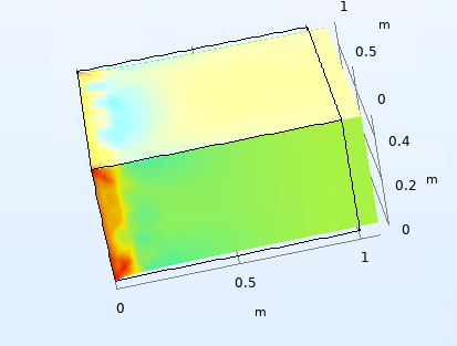

I am fairly new to COMSOL and was playing around. I simulated a block of a rubbery material. When I fixed one boundary and assigned a displacement to the other, the limit at which the it stopped "stretching" was below the assigned displacement?
I experimented from adding forces etc, but the displacement is the same?

Hello Ewe,
Check if you may have committed this common misinterpretation.
Jeff Hiller
Hello Ewe, Check if you may have committed [this common misinterpretation](https://www.comsol.com/forum/thread/231422/how-to-prescribe-displacement-amplitude?last=2019-04-09T20:55:03Z). Best, Jeff
