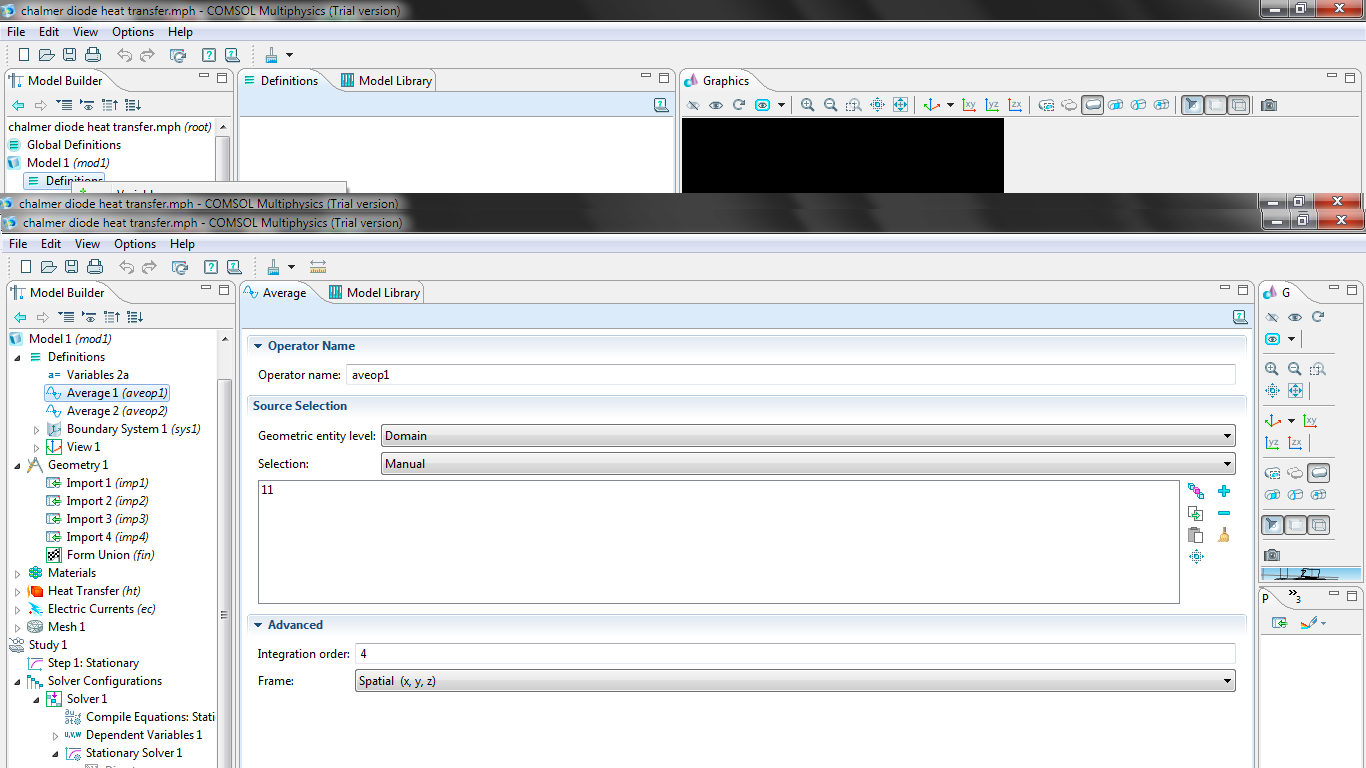

You can always define a global MyT as aveop1(T) over some domain or oundary nad decide to link some of your dependences on "T" to MyT, then you force the same scalar value MyT to all elements defined

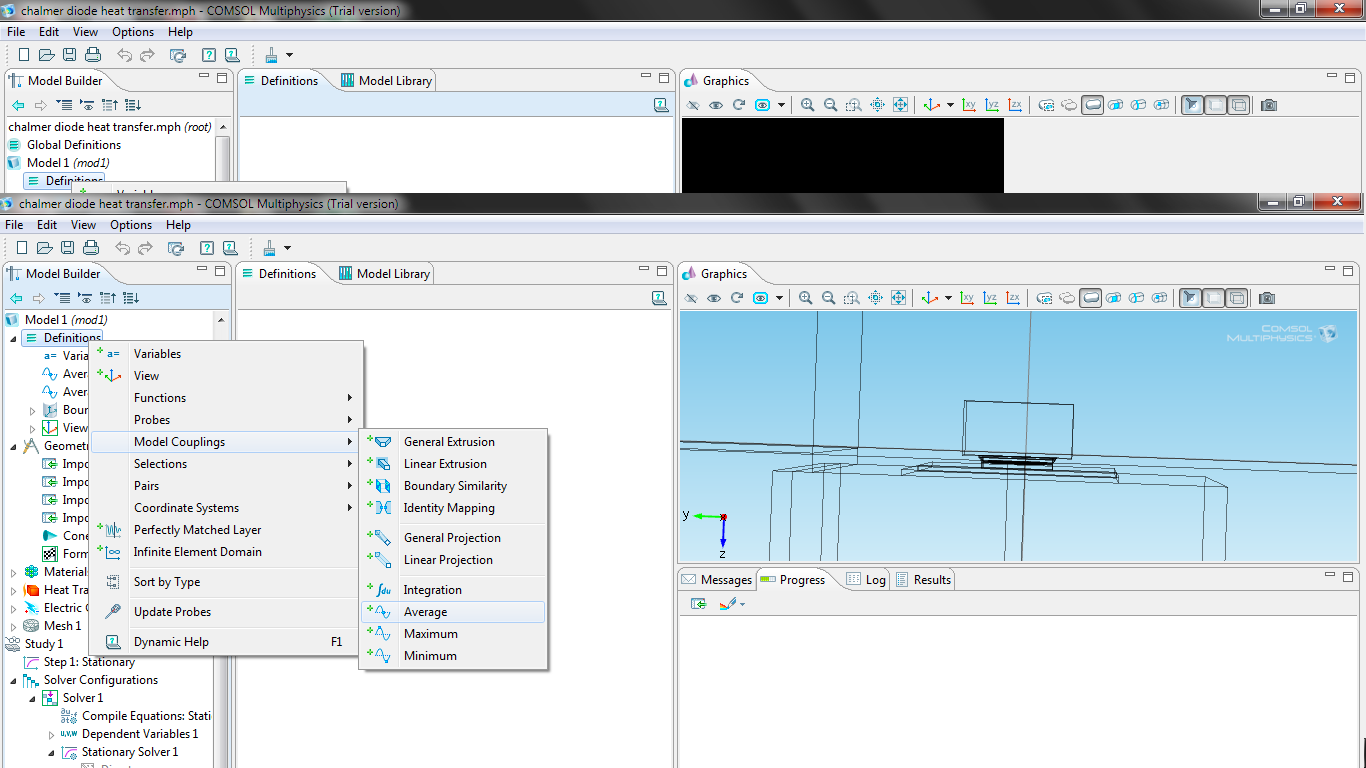

so, for example, if I want the average of the concentration in a domain, I go to Detinitions-Model Couplings-Average, I choose the domain and then in the operator name, I write:
aveop1(c), but then it says
"Invalid property value
-Property: opname "Operator name" is a string. Must be a valid variable name"

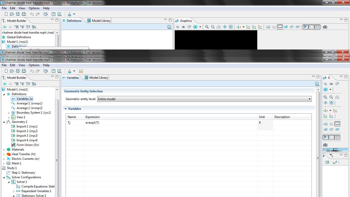

I think I got it, first I just simply define the average operation, I create aveop1 selecting my domain.
Then I create a variable for that specific domain, for example:
c aveop1(c1)
and now I can have all my properties in function of the average concentration "c" , like
rho (density)=(1+0.00934*c)*(A+B+C)
Am I right??
