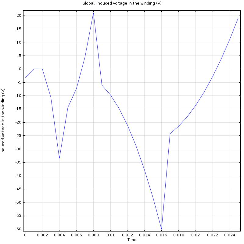

at 127 rpm and 32 poles it takes only 0.015s to rotate from 1 pole to the next. Is your time stepping too coarse and you are observing just an aliasing result?

As i said i am using for time stepping "linspace(0,0.03,30)". I have already increased it for linspace(0,0.03,100) but the bad induction presists. I thought that with more steps the problem should be gone but it didn't. Is this what you are suggesting?
Do you think that i should increase it even more?

Sorry, I got the syntax of linspace confused. The time stepping is probably ok. You might still check if you chose explicit timing in the solver.
Another issue might of course be the meshing.

Sorry to ask but what is the "explicit timing"?
I tried to attach the file of the comsol but it is too big. I will try to attach 1/8 of my generator so you could see what is wrong if you don't mind.
For the mesh i set it to "Finer" and then make for 2 in "Resolution of narrow regions" like it was in one of the models.
Thank you again for your support sir.

I think what i had was indeed a aliasing result. I can get now a sin wave for my induction voltage.
Now i am trying to see what my losses are. I read that hysteresis losses are difficult to compute so i am focusing in eddy current losses. I have already read the exemples presented in the model library but i don't know if i am doing it right.
After i solve my generator for trasient mode, i am making a subdomain integration from the prostprocessing menu and selecting the "resistive heating" (Q_emqa) from predefined quantities.
I can get the results directly for each time step but the unit of my result comes in W/m when i was expecting in W/m^3.
I can't obtain the average resistive heating because i am not using the heat module.
What am i doing wrong? I don't know if i am making a confusion out of it.
