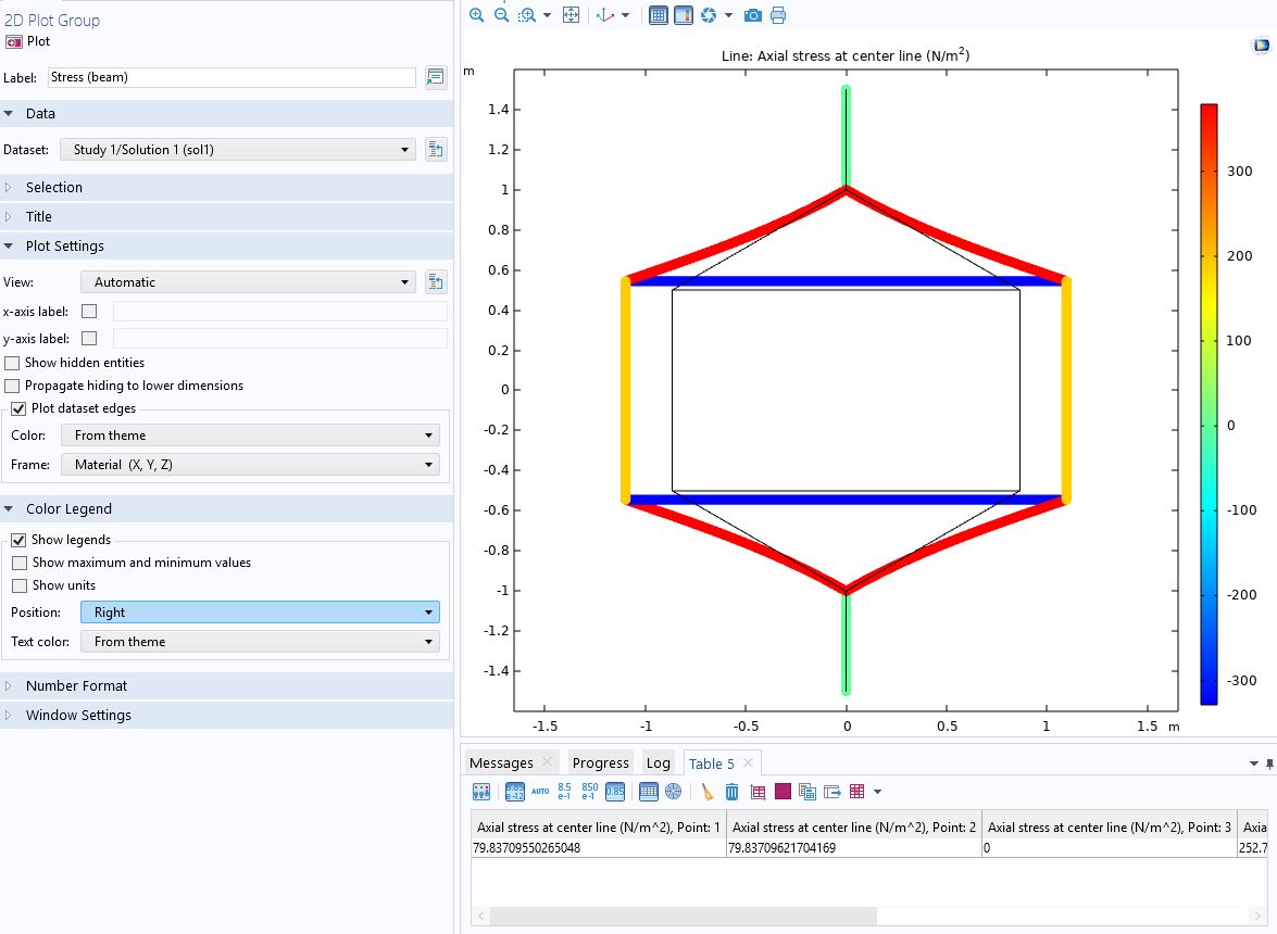

I saved my comsol file and it works fine, I have values of stress and displacement, but I don't know why I can't read them on COMSOL.

mpheval and mphinterp assumes you wish to extract data from domains.
For beams you want to extract data from edges. Hence you have to use the edim option.
Hence this is how you use mpheval:
data=mpheval(model,'beam.sn',"edim","edge")
You propably want to use mphinterp in most cases. Here is how to extract data from edge number 3:
c = mphgetcoords(model,'geom1','edge',3)
v = linspace(0,1,10) % 10 points along the edge.
coord = v.*c(:,1)+(1-v).*c(:,2) % lerp (linear interpolation)
dat = mphinterp(model,'beam.sn','edim','edge','coord',coord)
