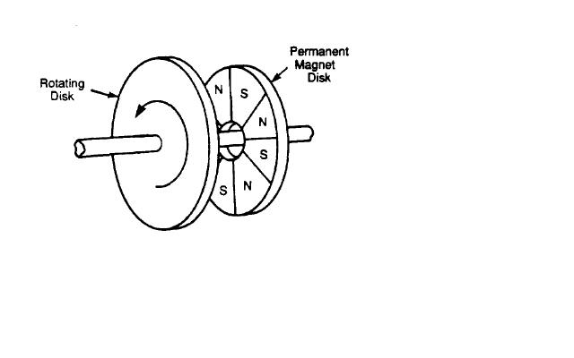

I am building a 3D model of a permanent magnet disk. So, I ask if someone knows how to model the Permanent magnet as shown in the attached file.

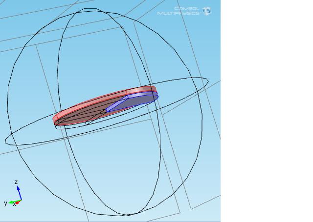

My model is composed by a Permanent magnet disk and a rotating copper disk (see the attached file Permanent magnet disk).
To do that, I created a sphere, a disk and another disk divided in four parts (see fig2: the red one is the copper disk and there are four magnet under the copper disk alternately magnatized).

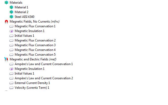

I have used 2 physics: 1/ Magnetic fields no currents (mfnc), in order to create the permanent magnets. (domain selection = all domains)
2/ magnetic and electric fields (mef), in order to define the induced current and then calculate the resulting torque in the roatating disk . (domain selection = all domains)
In the mfnc, I created the four parts of magnet alternately mgnatized
and in the mef, I have defined the the velocity of the disk (-y*w,x*w,0) and the external current density Je = sigma * w * B * (x,y,0). (sigma = conductivity and w is the angular velocity).
See the attached file fig3 for the physics part.

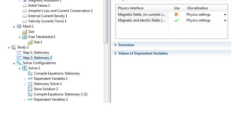

For the study, I have done 2 stationary simulations: for the first simulation I deselected the mef physics interface and for the second I select mef and deselect mfnc (See fig4).
when I simulated the model, an error message appear: out of memory in stationary solver.

I want to simulate this magnet (see attached file) and then see the effect of the induced magnetic field in a conducting disk that is situated under the magnet. I choose the magnetic and electric filds (mef) physics.
