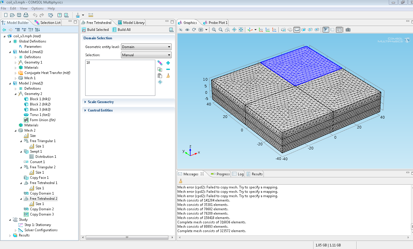

I did what you recommended (splitting the air into 3 parts and increase mesh density) but my model still does not converge.
I looked at the screen capture you provided and it looks like your mesh is much more sophisticated than mine. Am I correct? How did you go about making your mesh? Or is the standard meshing that I used fine? I have attached my model again.
