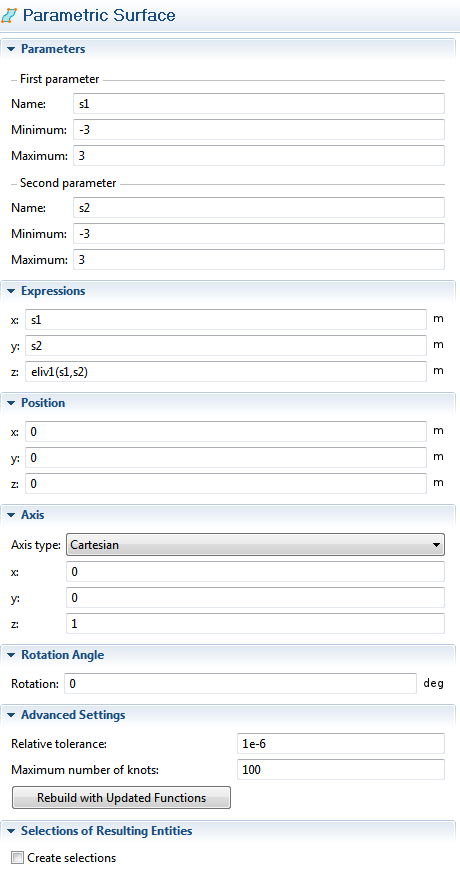

2) create a parametric surface in the geometry (I have included screen shots to illustrate).
However, I do not appear to be able to generate the surface at all. Have I done something silly?!

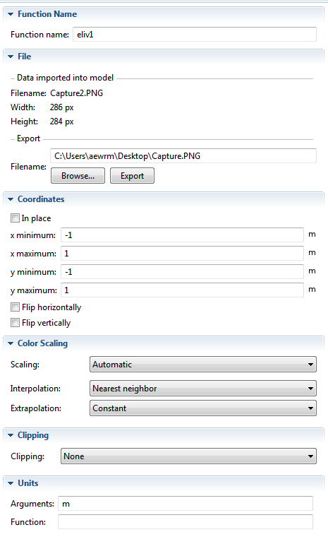

I think I may have solved the problem, kind of.
The issue was resolved by defining the image in Global Definitions not the Model Definitions. Once I did that the image and the Parametric Surface worked.
I am still trying to figure out exactly how to use it, but I am getting there.

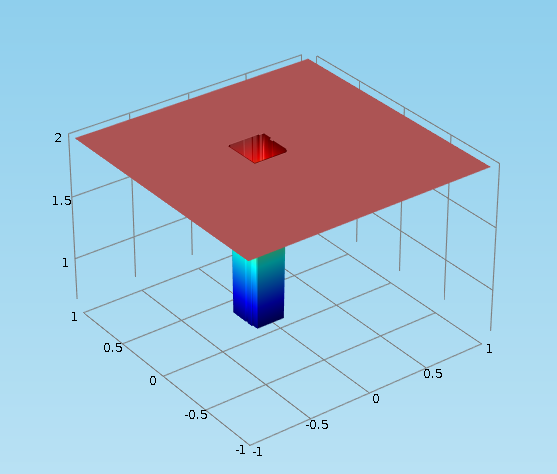

If I have an image, and lets say that white pixels are represented as 1 (the range being 0 to 1), is there a way I can set a condition for the Parametric Surface for values above say 0.5 to be ignored?
The example I am working on is a 2D image showing elevation represented in colour. I can import the image and the parametric surface with no problem, but I would like to ignore all heights below a certain level.
Anyone got any ideas?
something like....
image1(s1,s2) for image1(s1,s2)<0.5 or something similar.
Any ideas would be very welcome!!

dear rob
may i know how to set the parametric surface in the geometry ? or where i can find it ?
i just import the image import the comsol but i can not go to next step since i do not know where to find the so-called"parametric surface"
