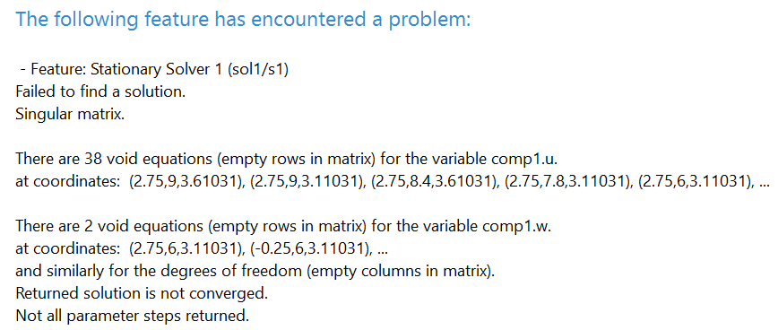

Hi Suppose I have a structure which I model with beam elements which is supported by a truss structure underneith, modeled with truss elements. How do I connect this two? Does Comsol to this automatically?
See the attached png file for the error I get.

The default is that each physics interface has its own set of degrees of freedom. The simplest solution in your case, is to change the name of the Displacement field in the Dependent Variables section of one of the Truss interface, so that the same fields as in the Beam interface is used.

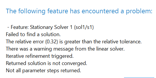

Putting the beam interface before the truss interface seemed to help, definitly seems like a bug(?). However now I have a third error, see the attached png file. I made a very simple truss and beam model, which I also have attached.

The model you have attached is not statically determinate (stable). It has two rigid body modes, something that you can see by computing the eigenfrequencies.

One problem is that since the beams only have translational constraints, they could simply be replaced by truss elements, and then one of the unstable modes is evident.
However, even if you completely remove the beams and put pinned conditions where they were connected, the truss structure in itself is not stable. It does fulfill the fundamental condition
(number of bars) + (number of constraints) = 2 * (number of joints).
That, however, is only a necessary condition for static determinacy. It is not sufficient.

I am afraid that changing how the truss structure is connected at its ends would not fully fix your problem: as Henrik mentions, your truss structure on its own (e.g. even if there were no beams and the truss structure were pinned to the ground at both ends) is not stable. That instability would be removed if the truss elements were replaced with beams (I am always a bit skeptical of the use of trusses); you would need to decide if it is a realistic representation of the real world situation you are modeling.
