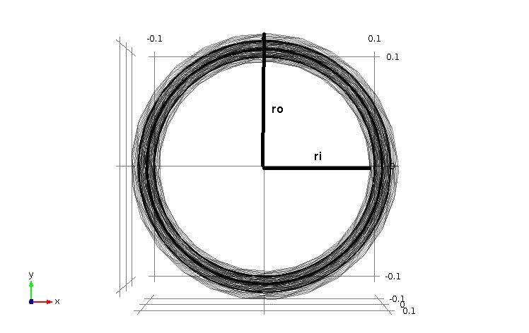

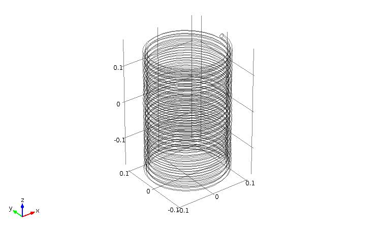

We are working on a 3D multi turn Helix model (as attached) with following parameters:
Number of turns (N) = 24
Current (I) = 50 Amps
For current density we are using the formulae:
Jx = J*y*sqrt(x^2+y^2)
Jy = J*x*sqrt(x^2+y^2)
where J = N*I/A
Here we know the values of N and I, but we are confused on what to use for the value of Area.
We believe it should be:
1. A = pi*ro^2 - pi*ri^2 (where ro = outer radius and ri= inner radius as shown in the figure Top view)
or
2. A = pi*r^2 (where r = radius of the coil)
It would be great to have your guidance.
Uttam M. Pal
you need to tell us which version, and which physics you consider (3D MF I suspect, with V4)
there are different ways to simulate a coil, in full 3D it requires a high mesh density hence quite some RAM and time to solve, it's much quicker in 2D-axi with or without the advanced coils domains.
One way you select the wire section and define a current density J0/Awire [A/m^2] (where J0 is the current in one wire and Awire is the wire section (not the coil)
But you can also in 3D select your twisted coil domain and impose a current of the type J0/Awire in a predefined Cylindrical Coordinate system for the "sys2.phi" direction or as you do it in x and y (check the sign and plot the current vector to be sure it loops around)
You can find some example hereby (4.2a)

We are using Comsol 4.2a in 3D, Cartesian coordinate system. We have tried with 2D Axi symmetric model and it is matching with the experimental results.
I would like to rectify my errors and hence the correct form (of the helix) is:
Jx = J0*y/sqrt(x^2+y^2)
Jy = -J0*x/sqrt(x^2+y^2)
Where J0 = N*I / A, where A is the cross sectional area of the wire (not the coil) = pi*r^2, where r is the radius of the wire. N being the no. of turns and I is the current (Amp).
In experiment we are using N =40, but due to computing constraint, we had to use N =24 in 3D simulation.
The difference between the simulated and experimental B Field flux density is around 3-5 Gauss, would it be because of the no. of turns which we had to choose less because of the constraint of computing resources?
