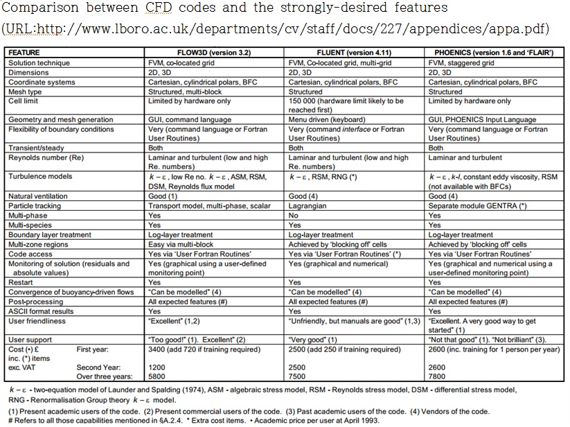

I'm newbie on CFD and have to choose CFD program between Comsol, Flow3D, and Fluent.
To do this, I have to compare them.
But , COMSOL's specific features gathering is not easy (Flow3D, Fluent was easy-like attached file).
So, If you know some pages about COMSOL's feature or comparison charts about CFD program, it will be very helpful.
