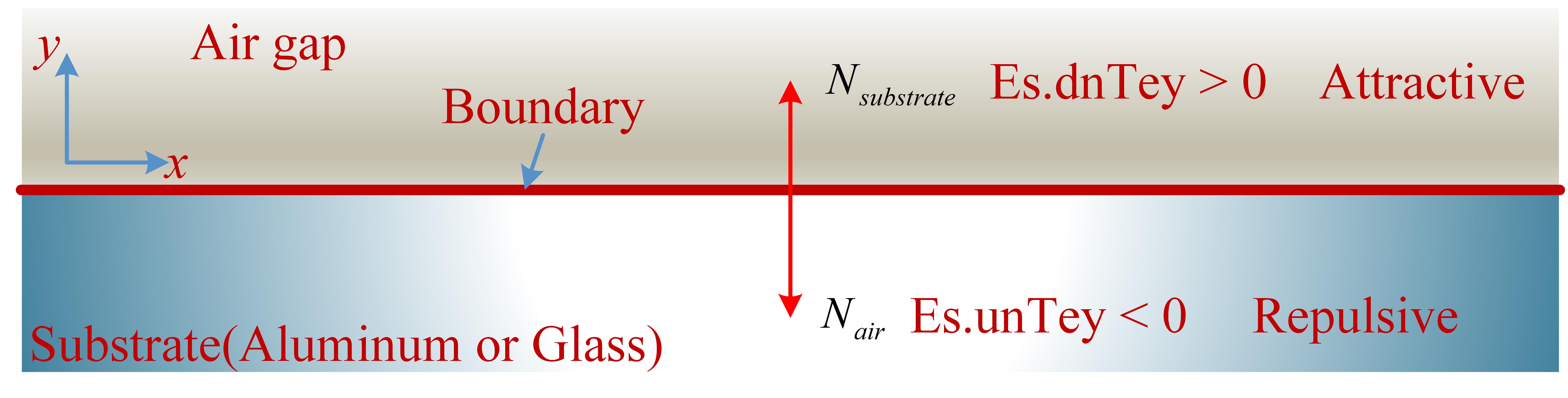

Dear Mr. Olsson, Thank you very much for your further explanation! With your help, I can basically understand all the questions I consulted you above. But as for the signs of es.unTey and es.dnTey, I'd like to consult you in combination with the schematic diagram (as shown in figure.jpg in the attachment). Because I don't quite understand what you mean by "other piece" at last. I'm afraid I misunderstood it. In the figure.jpg, the Cartesian coordinates are represented by x and y, respectively. The boundary between the air gap and the substrate is described by the thick red solid line. The Nsubstrate represents the normal vector of the substrate at the boundary. And the Nair represents the normal vector of the air gap at the boundary. The results of the solution is es.unTey < 0, es.dnTey >0 (As you get from your model). Now, my understanding is that: es.dnTey >0, and its normal vector direction coincides with the positive direction of Cartesian coordinates y, so the “+” sign of es.dnTey means “attractive”; similarly, es.unTey < 0, and its normal vector direction is opposite with the positive direction of Cartesian coordinates y, so the “-” sign of es.unTey means “repulsive”. Is that what you mean? Thank you again for your patient explanation. I look forward to your further reply. Thanks!
The surface Maxwell force density is defined as (es.dnTex+es.unTex , es.dnTey+es.unTey). In the attached version of the model, this is plotted on the surfaces of the substrate (white arrows) and the chuck (black arrows). Now, when looking at the sign of the Y component, it is clear that interpreting that as "attraction" or "repulsion" depends on what piece (substrate or chuck) you are evaluating at. Further it depends on the relative positions of the chuck and substrate - rotate the geometry by 180 degrees and the signs/vector directions are reversed, rotate by 90 degrees and you have to look at the X component, etc. etc. That is what I mean by "your bookkeeping" and why I am reluctant to state something like "positive sign means attraction" as it depends on how the model is defined/oriented and on what side of the air gap you are evaluating.

Dear Mr. Olsson, Thank you very much for your patient explanation and help. Based on your explanation, I fully understand the problem now. Thanks!
