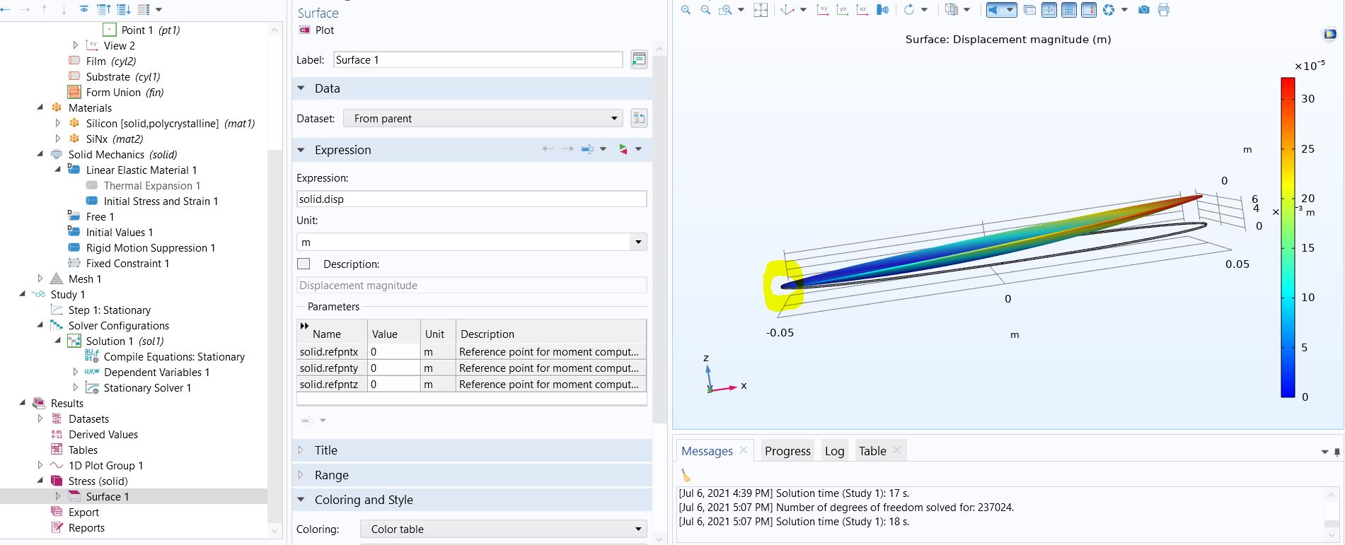

Hi! I am new to COMSOL and I am having an issue with my model's behaviour that I could use some help with. I have attached a screenshot of my model and circled the area of interest. My goal is to achieve a bowl-like figure as a result of stress, but due to an unknown constraint it seems the leftmost point is unable to move, which is unrealistic. I have included the toolbar in the screenshot to show what I currently have implimented, I believe the issues lies in the Rigid Motion Suppression Domain. If anyone has any advice/knows what might be causing this behaviour please let me know!
