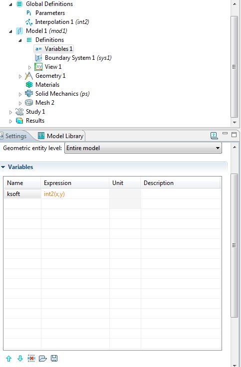

I then have the following two lines:

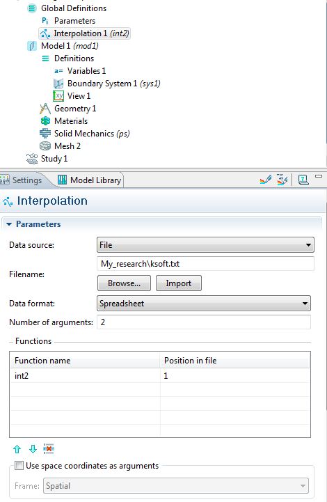

model.func('int1').setIndex('funcs', 'int2', 0, 0);
model.study('std1').run;
To know what the int2 is doing, I attach a screenshot.
I guess that implementing directly from MATLAB array should also be simple but I have not had time to do it.
Sorry I cannot be of more help.
Suresh

Posted: 1 decade ago 7 giu 2012, 21:47 CEST
Suresh,
I'm not quite sure what your last 2 lines accomplish. I managed to get COMSOL to read and interpolate the .txt file by setting up int1 and the variable by hand in COMSOL, but I need to be able to set these through MATLAB (since it's going to iterate in a MATLAB loop). Any thoughts?
Thanks,
Brian
Suresh, I'm not quite sure what your last 2 lines accomplish. I managed to get COMSOL to read and interpolate the .txt file by setting up int1 and the variable by hand in COMSOL, but I need to be able to set these through MATLAB (since it's going to iterate in a MATLAB loop). Any thoughts? Thanks, Brian

Posted: 1 decade ago 7 giu 2012, 23:19 CEST
Hi Brian,
I am not sure of your question.
All the lines I gave you are to be written into a program file that you create in matlab.
If you are loading filename.m file then the interpolation command would already be in the m file itself so you probably don't need it. This script and many more would be necessary if you are writing out the entire script yourself without calling the m file.
The next line "model.study('std1').run;" is necessary because I have to run the model. What I showed you was just an extract from a much larger matlab input file. I have a lot more scripting to effect changes at every time step within a loop and therefore I run the model after changing them. I am not sure if I understood your question correctly here. So I attach here again a partial code that may help you a bit more.
Alexander is right that it is better to call matlab array directly, because in this approach, as you have guessed you have to keep writing data into a text file at each step of the loop. I think this could be slow. I had no problems with accuracy at least for the problem I was solving, it also depends on how many data points you have.
Suresh
