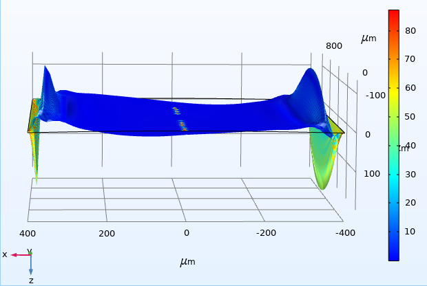

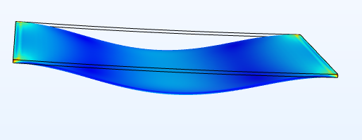

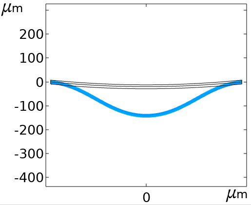

Unfortunately I do not get them. Using the membrane physics (2d model in (xy) plane), I get an instability but not the expected one. And for a 3D model with the Solid Mechanics Physics with a very slight initial curvature, I observed only a simple increase of the curvature for a very large range of stresses. I also tried with a cut of the plate (2D model in the (xz) plane) but no success either. I used the Linear Elastic Model and Hyperelastic Model (Neo-hookean). I have attached somes images for those 3 attempts.
