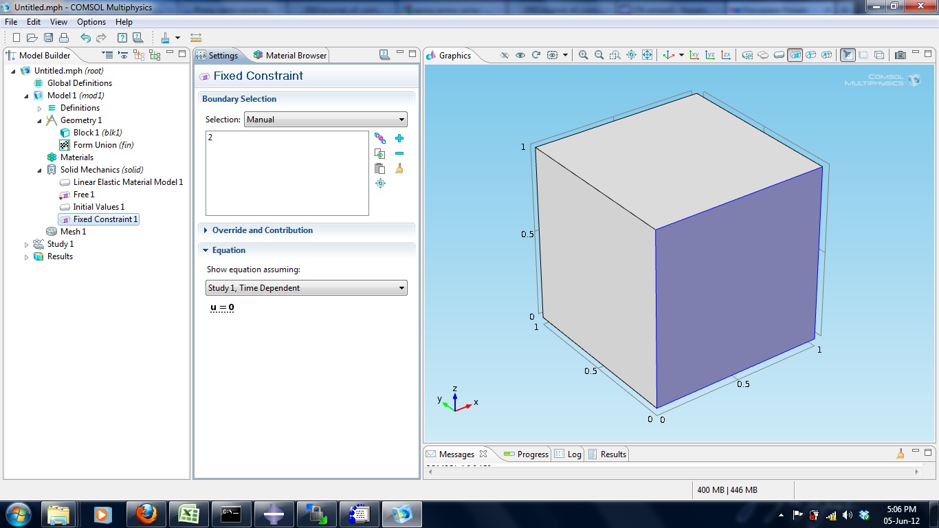

Hey can somebody tell me how to apply fix boundary constraint in Ux only & to release Uy & Uz.
Right now there is a procedure to apply u=0 only.
Kindly help me out on this the jpeg image of the problem is been attached for reference.
Thanks in advance..

Don't use fixed constraint then, because it is fixing u (displacement vector) = 0.
Instead, choose prescribed displacement option and specify just u0=0, and leave out v0 and w0. If this is what you want?
