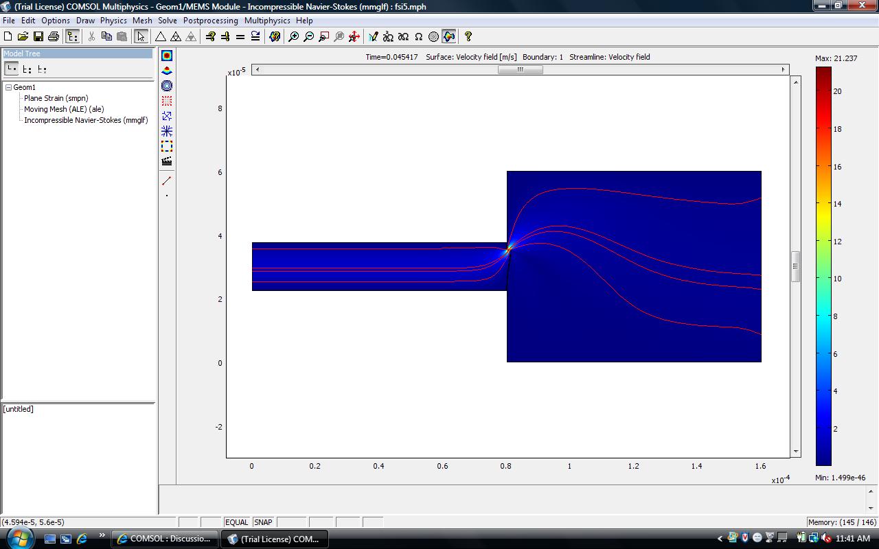

                                                    I am attaching an image of my problem. This is the solution when I reduce the dimensions of my model, it exits after solving for 0.04 seconds. It exits for first time step, if I use orginal dimensions.

did you check relative and, above all, absolute tolerances, in your time dependent solver?
It is often better to set absolute tolerance for each variable you solve for. Within Comsol manuals (time dependent solver part), you see how to do this.
Please always set an absolute tolerance with is, at least, one order of magnitude lower then the magnitude of your variable, so that the time dependent scheme can go on safetly.
Clearly you have to know in advance, roughly, what is the magnitude of your displacements, velocities, and so on...
Moreover,you have also to check time step. If you want to correctly simulate vibration, you have to use a time step which at least about 1/10 of the period of your vibration. If you use therefore a too large time step, the time dependent scheme will probably fail, since the solver is not able to satisfay all tolerances within the time step you request.
I saw from your pic, that you are using the ALE application mode.
This is correct, but you are just interested in the *linear* vibration of your structure, you can avoid such a module and save computational cost.
Finally, please, be always aware that Comsol tutorials have always settings which are customized according to the problem under analysis. For instance, if you scale down the dimensions of the solid, it will be probabily vibrate at higher frequencies and therefore the default time step suggested by Comsol will be no more valid for your case.
I hope this helps.
Alessandro
