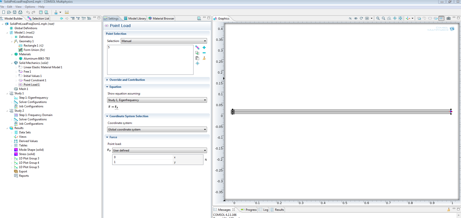

well I do not have any earlier version than 4.2a up running, but here is a screen view, the point load is not the best way, the better is a boundary load on the tip edge, but in this case you get the same results
Hi well I do not have any earlier version than 4.2a up running, but here is a screen view, the point load is not the best way, the better is a boundary load on the tip edge, but in this case you get the same results -- Good luck Ivar

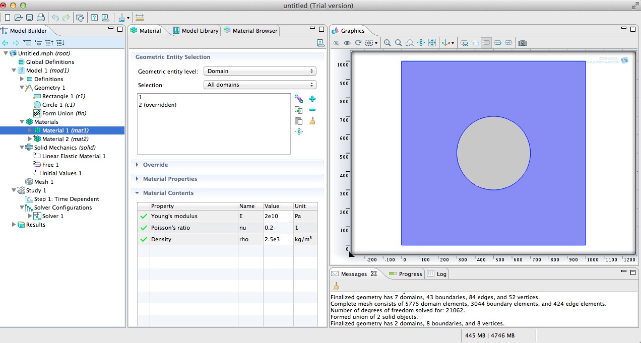

Sorry to bother you, but i find your model almost fits my problem. "Scientists and engineers that seek to understand elastic wave propagation in geological structures typically consider the generic problem of a seismic wave that is generated at a source, propagates through a media, and is measured at a receiver." describes my problem perfectly. In my case, the media contains two different isotropic material. What i want is the waveforms at different receivers. I am wondering if you can help me with this. I assume there is a boundary load on the top boundary of material 1. Please see my attached geometry file. Thank you so much.
