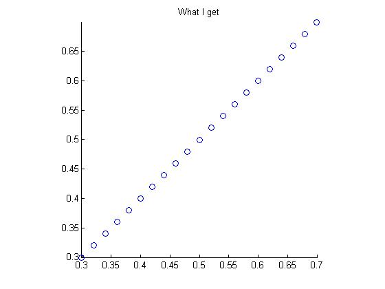

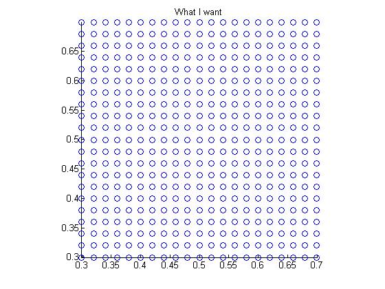

I am using the particle tracing module in comsol 4.2 to track charged particles in an electric field in 3D geometry. I basically need to release particles from the top plane of a cube and tract their motion towards the bottom plane in an electric field.
I know how to release multiple particles simultaneously using the range function. If I use X=range(0.3,0.02,0.7) and Y=range(0.3,0.02,0.7) and Z=constant, then I get a line of particles released. (see image what_i_get)
How do I get a 2D grid of particles released simultaneously? (see image what_i_want)

Aditya, my version of Matlab is so old, I'm not sure your solution will work for me. I did find one other workaround. I realized that it is possible to enter a long sequence of coordinates without using the range command. For example:
x: 1, 2, 3, 1, 2, 3, 1, 2, 3
y: 1, 1, 1, 2, 2, 2, 3, 3, 3
So if you want a grid that is 3 rows and 10 points in each row, you have to enter 30 numbers in both the x and y input boxes. This is a real pain, especially if you need to calculate odd spacing. But it is possible to generate the correct sequence in Excel (where you can use equations to create the proper spacing as needed), and then export to a CSV. Then you can open the CVS in a text editor, copy the number sequence and paste into the Comsol GUI. Still kind of a pain but it did work for me. I think it would also be possible to create a serpentine polygon in the domain that you can define as a selectable boundary. Then you can define points evenly spaced along this polygon using boundary coordinates. I didn't try this yet because the CSV trick ended up working for me.
