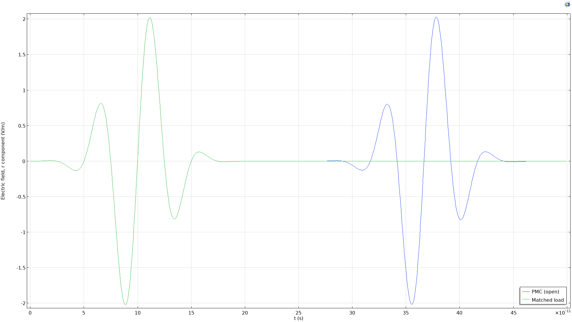

The model is using a pulse that gives a maximum Magnetic vector potential (A) of the order 1e2. This A field is the only dependent variable, and what matters for the numerical method. The E field and other postprocessing variables are not relevant for scaling or for termination of the solver methods.
The automatic scaling is not being able to pick up the correct A-scale since it is not considering any transient (boundary) data or behavior. It is based on initial values, zero here, which leads to a fall back to “1”, which works fine here for the port-pulse size in the model. When the pulse is scaled, naturally the “A” field is changed. But the automatic scaling does not pick this up, it is still “1”, and very off. By correcting this by using Manual scaling A ~ 1e2 * 1E-13 = 1E-11, things are just fine. The model can then be improved further by using a manual time-step of 5e-13 and the model solves in 9 s on a standard machine, with good accuracy. Attached is a screenshot from COMSOL version 5.6 with the “normalized” E field. Both open and matched BC are shown. Observe that with manual time-step the model is not as sensitive to the correct scaling since the time-step is not selected based on error estimates anymore (which requires correct scales). But in general also for this case proper scaling is needed, since else the algebraic problem (solved in each time-step) can be off.
