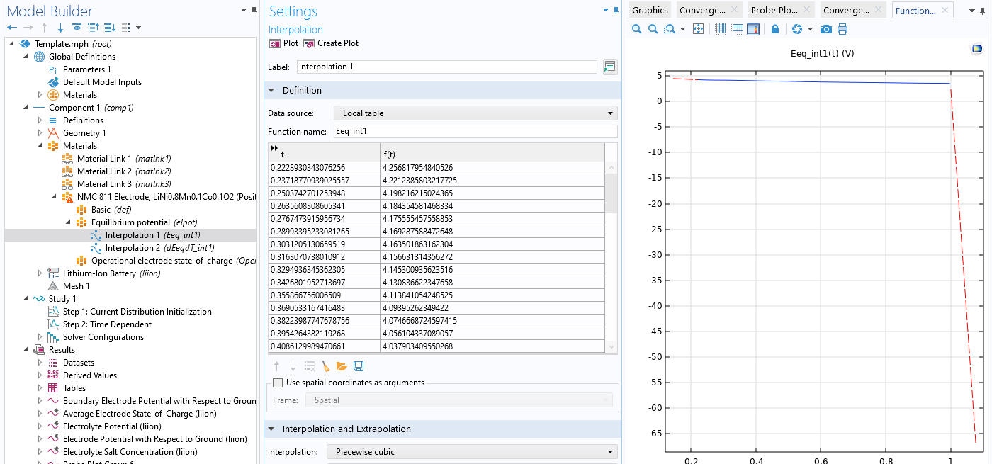

I think the best way is to generate the data point from 0 to 1 SOC. and copy the data point into comsol to generate a point. like what they did for all the other materials
Posted: 5 years ago 26 mar 2021, 01:50 GMT-4
@XiuQun Cui from where i can generate the data. I am only doing numerical simulation,
