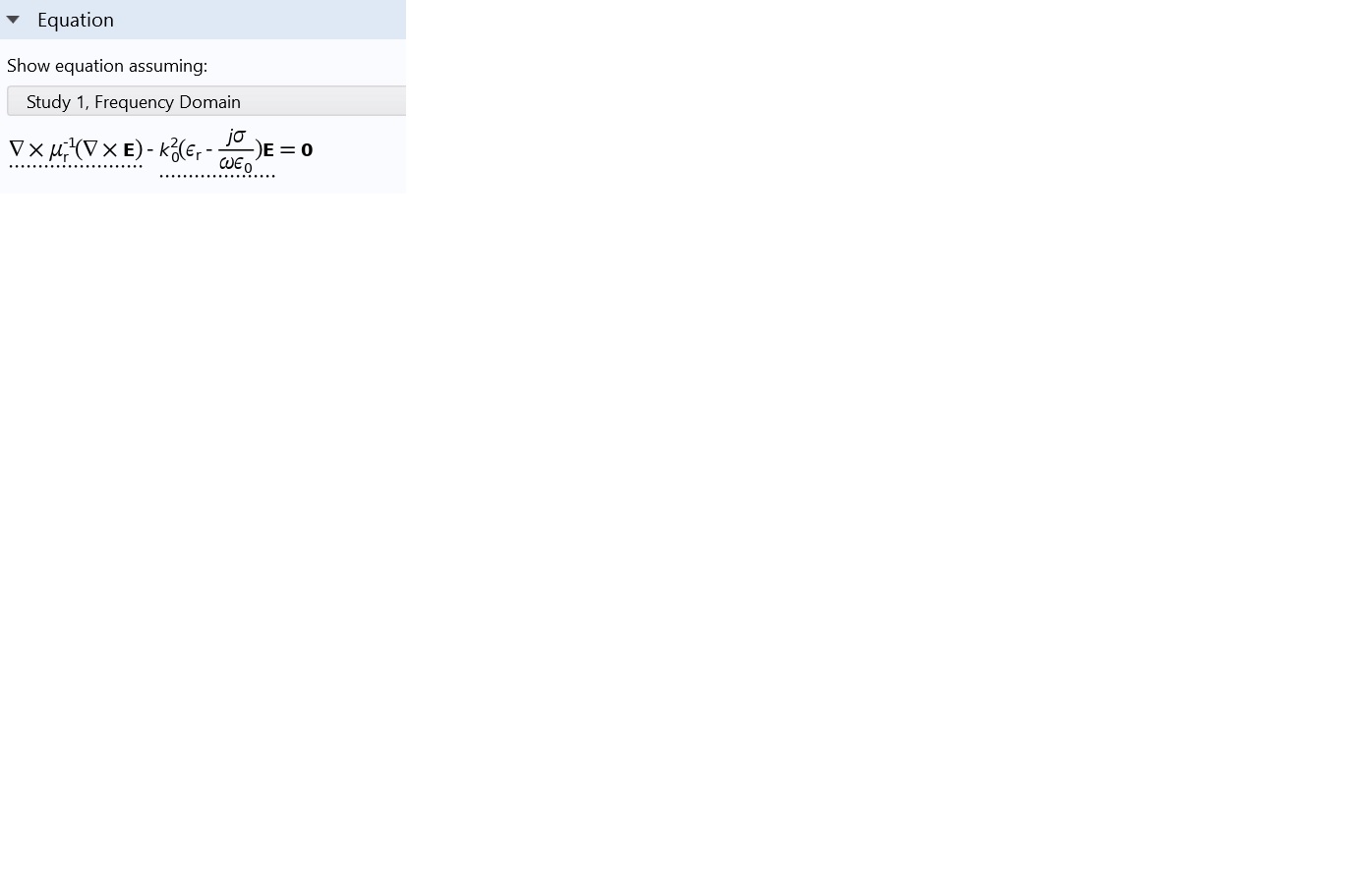

Interesting question. The use of "frequency domain" to solve RF problems removes the time parameter from the problem, i.e., the differential equation becomes literally "time-independent." See the attached image. A time-domain exponentially decaying signal is not a "single-frequency" signal. And I can see that an attempt to specify a complex frequency fails. That said, a signal that decays spatially can certainly be modeled in the frequency domain. Perhaps one of the real Comsol experts here can offer a comment on whether there is any hope at all for doing what you want to do via using a frequency domain interface. I would suspect that aside from some kind of trick (such as employing various transform operations in post-processing, or adding some clever analytic feature to the model that would effectively allow an interpretation as if it were time domain), you will probably have to work with a time domain solver.
Interesting question. The use of "frequency domain" to solve RF problems removes the time parameter from the problem, i.e., the differential equation becomes literally "time-independent." See the attached image. A *time-domain* exponentially decaying signal is not a "single-frequency" signal. And I can see that an attempt to specify a complex frequency fails. That said, a signal that *decays spatially* can certainly be modeled in the frequency domain. Perhaps one of the real Comsol experts here can offer a comment on whether there is any hope at all for doing what you want to do via using a frequency domain interface. I would *suspect* that aside from some kind of trick (such as employing various transform operations in post-processing, or adding some clever analytic feature to the model that would effectively allow an interpretation as if it were time domain), you will probably have to work with a time domain solver.
