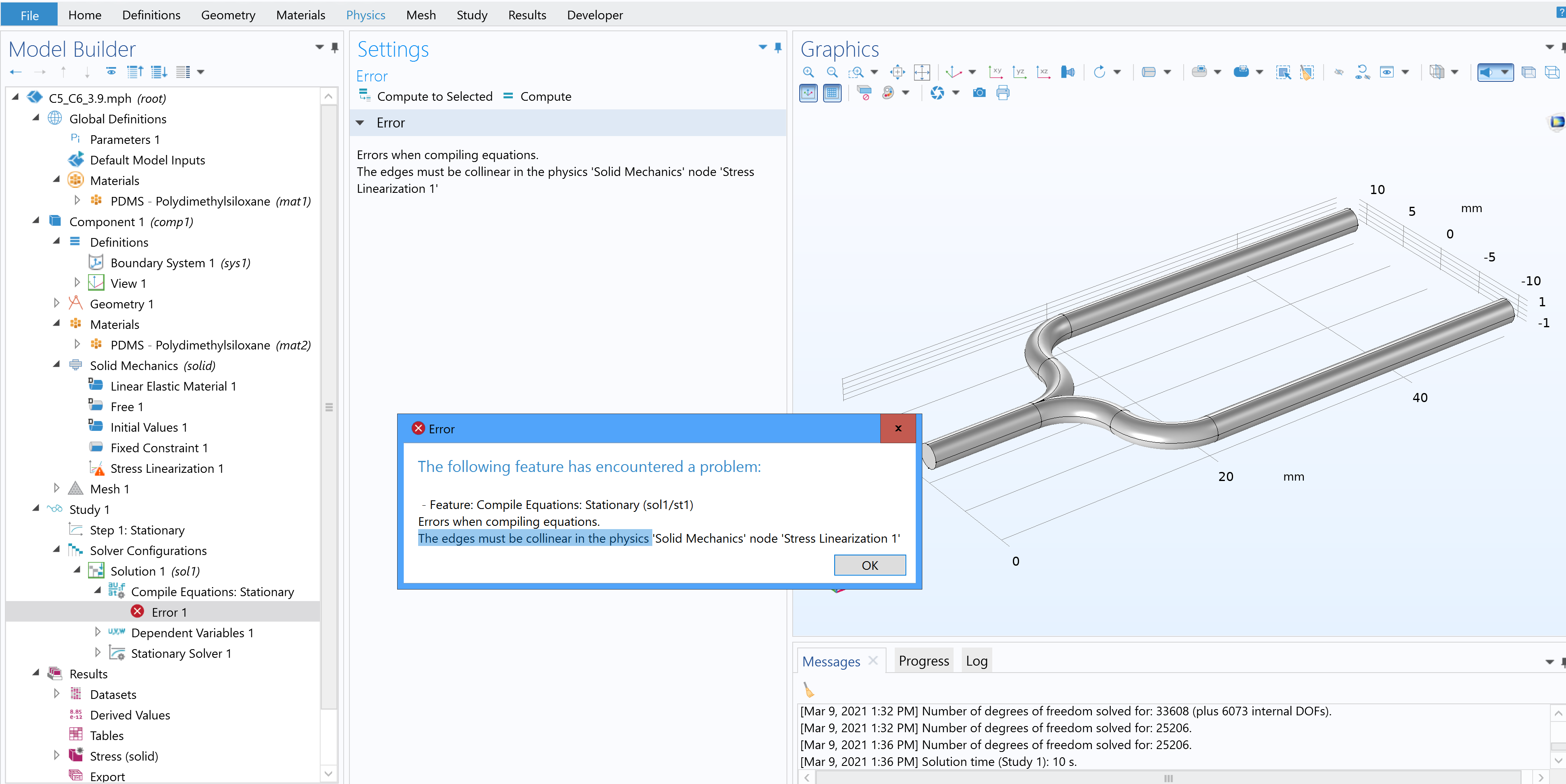

COMSOL Beginner - creating 'nerve' junction into one nerve
I am creating a nerve model . I am creating it as non-linear material and want to apply tension to one side. I have fixed constraints on two of the ends.
I keep getting the error " - Feature: Compile Equations: Stationary (sol1/st1) Errors when compiling equations. The edges must be collinear in the physics 'Solid Mechanics' node 'Stress Linearization 1'"
Any suggestions.? I do not know how to fix it.
I created my component. selected PDMS as material (for now) and selected physcis as solid mechanics.
