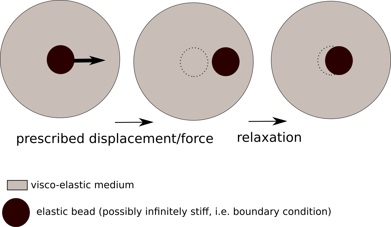

Here is a small sketch of what I want to achieve : illus
Here is a small sketch of what I want to achieve : ![illus](https://biophysics.fr/wp-content/uploads/2021/03/illus-1-1024x595.jpg)
