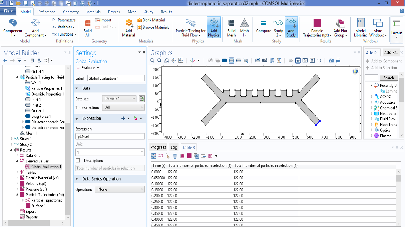

1) The subnode should be under the "Derived Values" node
2) Add a "Global Evaluation" subnode instead of "Particle Evaluation" subnode.
Under the "Global Evaluation" node, select "particle1" for "Data Set". You need also to add the "fpt.Nsel" under "expression".

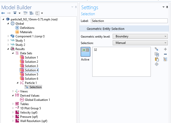

This is basically how to calculate the no. of particles in a chosen boundary. If you want to know the no. of particles in a specific boundary, just choose it. There is also a "time selection" in your "Global evaluation" settings. This indicate the total no. of particles passing your selected boundary from the beginning to your selected time.
Please make sure to have this "selection" node under "particles", and choose the boundary you want (see attached file). I believe that is the reason why you only have the total no. of particles.

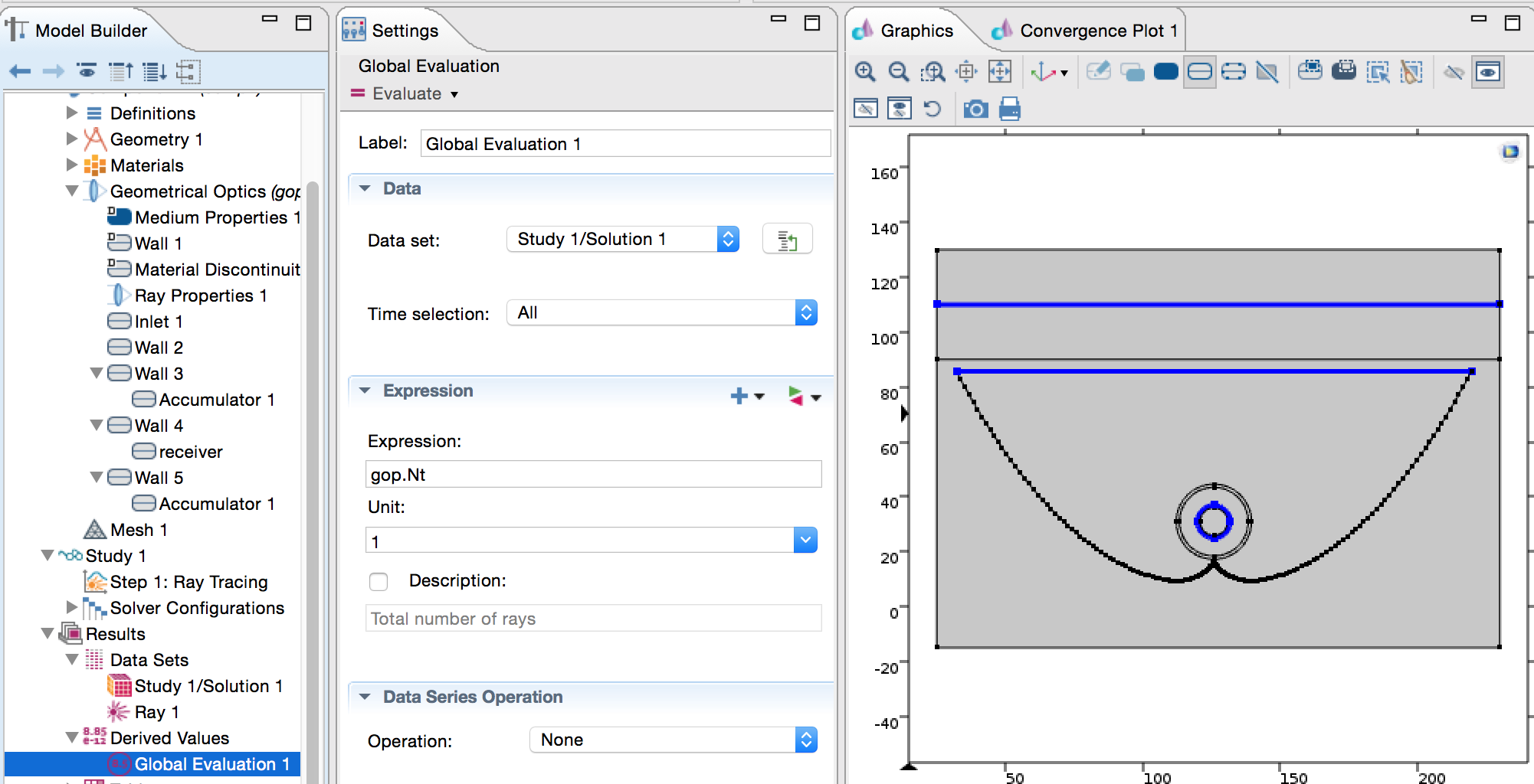

I'm doing something similar only for a ray trace simulation. How do I count the number of rays in a particular wall?
