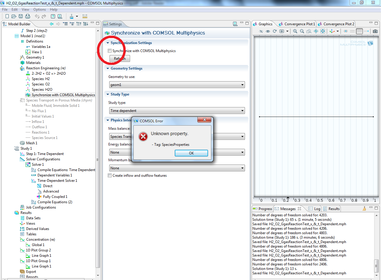

I have a question about the chemical engineering module (re) (1D). For testing purposes I modeled the reaction:
2H2 + O2 => 2H2O and this works on its own (no coupling or whatever) as a CISTR, fine.
But I want this to happen inside a porous reactor, in the gas phase. So I made 'Species Transport in Porous Media (chpm)' and I can model flow of species through the medium, also fine. But when I try to model every element as a CSTR, using the chemical engineering module to calculate the reaction, it does not work.
First of all, I don't really understand how to couple the concentrations. (re) uses H2, O2 and H2O, but (chpm) uses c_H2, c_O2, c_H2O, how do the two understand this is the same? Also, when I try to couple the two using 'Synchronize with COMSOL Physics' I get a really vague error (see picture).
In words: Unknown Property Tag:SpeciesProperties, But it doesn't say what property!
I checked the demo models and the forum and the knowledge base but I don't see the answer to this problem.
Any suggestions on how to model this kind of thing?
Any help would be really welcome. Thanks in advance.
Kind regards,
Ray
PS. Current model is attached.
1 reactor volume is defined as Vr/resolution (total reactor volume/number of elements) , that is the plan. Currently I multiplied with the resolution again, so the reaction volume is now just 1 m^3 again in the attached model.
