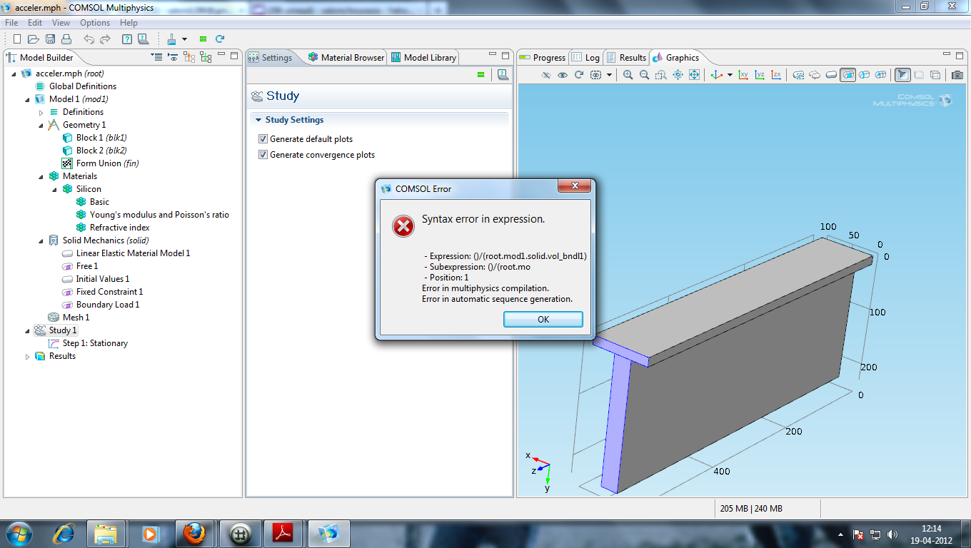

I am facing a problem while analysing a T shaped beam fixed at the T shaped cross section with a lateral load applied parellel to its flat top surface .It showing a compilation and syntax error .
Please help me out ASAP.Also find attached snap shot of the model with the concerned problem.

it looks like you have an empty field for an expression somewhere, or an empty reference, check your BC and their inputvalues. But it's only a guess, it could be something special
Hi it looks like you have an empty field for an expression somewhere, or an empty reference, check your BC and their inputvalues. But it's only a guess, it could be something special -- Good luck Ivar
