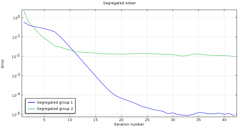

I have a simulation that is somewhat converging but I wonder about the behavior of the solver...
Please see attached picture for the convergence plot.
The segregated group keeps exhibiting the same behavior. Can anyone offer some advice or insight on this matter?
Is this mesh related?

not really , looks like a large simulations with slow convergence, so perhaps ma following comment does not apply:
I have notice that often, when I have enough RAM, to use the direct solver (and no segregation steps) I often see COMSOL converge quicker

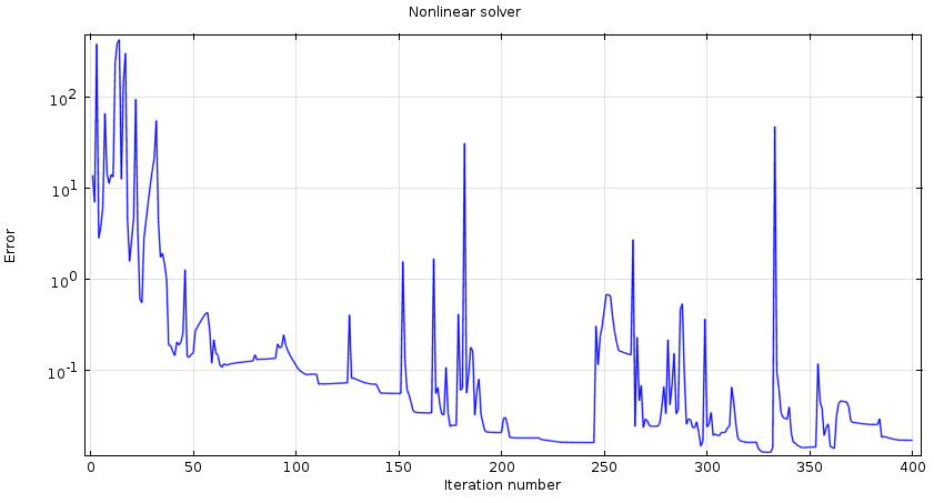

I have been working on other issues ans I have returned to question in this post.
Thank you for your suggestions.
However, the problem persists (see attached pic1).
So I used the Fully Coupled + Direct Solver as you suggested (see attached pic2).
Is there a way to somehow give a numerical "nudge" to achieve proper convergence. I have refined the mesh, but
still nothing. I also changed the Damping Factor to a much lower value but I get the same behaviour...
Any thoughts?

well the only I can suggest is that looking at your segregated group convergence, one group is getting "rapidly" stale while the other is slower. This means perhaps that you could solve for part of the variables, and use that asa fixed value and solve only for the other dependent variables, this should make the solving go faster, but you might integrate away too, so its not always the best way, finsihing in a global run with all dependnet variables, using the last solver step is a way to check that you are a t a optimum result point
I assume that segregated group 2 is for turbulent parameters (k and eps)? If yes, try changing turbulent length scale from inlet. Good default values is 0.07*inlet diameter. If this doesn't work try to solve problem with very coarse mesh and use this as start value for finer mesh calculation.
