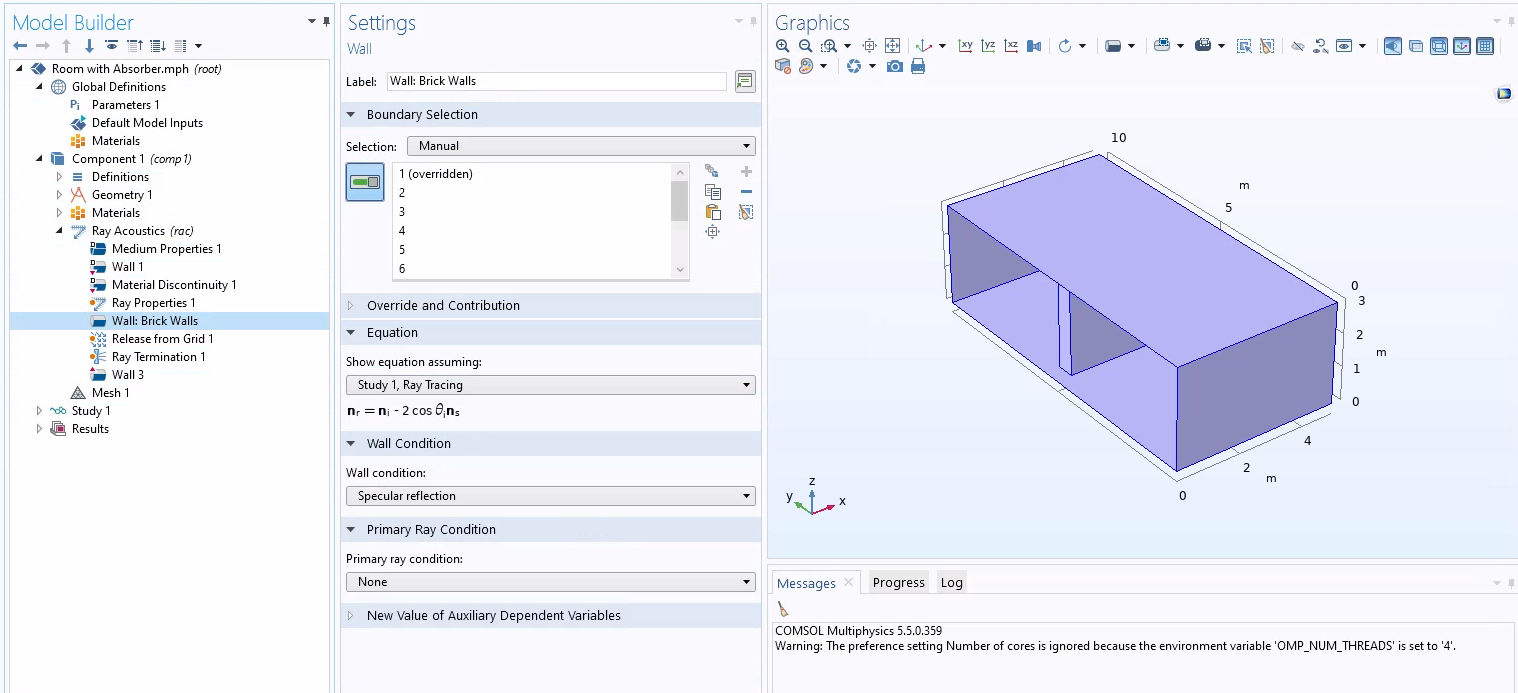

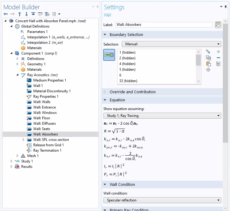

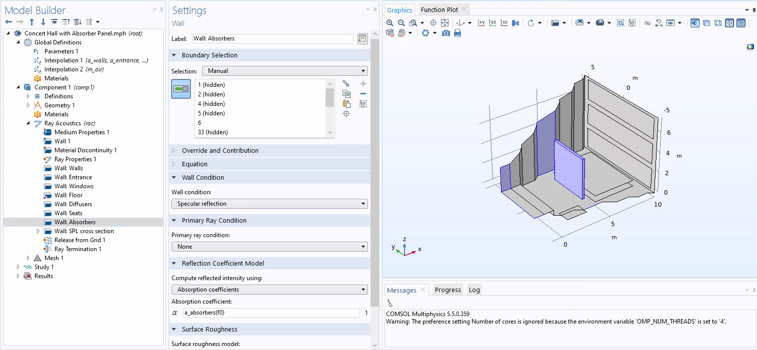

So far, I believe I have set everything up correctly, but there are some key differences in my wall boundary condition tab. I will attach screenshots to show the differences. I wish to carrry out the study in the same way, by using the Specular Reflection option for the wall conditions.
In the original tutorial file, selecting "Specular Reflection" as the wall condition opens up the "Reflection Coefficient Model" box that allows you to specifiy the absorption coefficient. In my version, this does not happen. You can also see that the equations specified for use in the tutorial and my own file are not the same.
